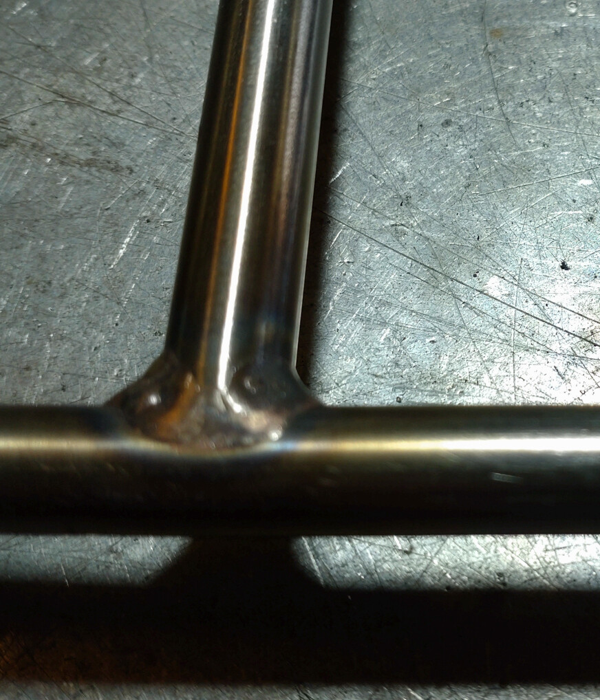

Here’s a picture of one of the joints. They seem to be pretty strong.
For my personal stainless steel racks, I’m willing to experiment with silicone bronze. I have been brazing stainless with nickel silver and have had great success but it can be very time consuming. The last stainless rack I made had over 30 brazed connections, it took a couple days to complete.

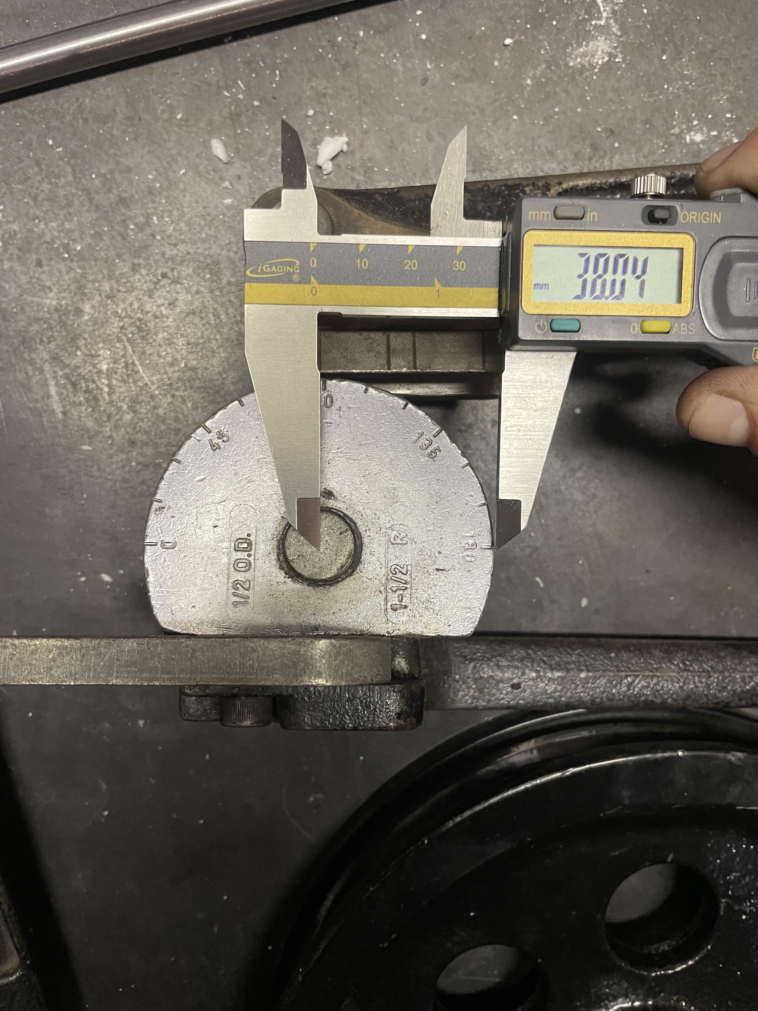

  3. If I’m calculating the bend allowance and deduction, I’m not entirely sure how the radius of the bender is calculated. Looking at my workshop mate’s bender, it has a 1.5” radius, and measuring it that’s the measurements to the very edge of the die, which if I’m not mistaken is pretty much the centerline of the tube and not to the edge of the tube (not sure I’m explaining this right, see picture below). So when I input the bend radius in the formula, that radius would correspond more or less to the neutral axis of the tube, and not its edge. Asking because in school we mostly worked with sheets and bend radius was always measured to the edge of the piece, then we had to calculate the neutral axis (or k-factor) depending on thickness, just want to make sure I’m getting this right.
  1. Yes on using a small internal sleeve. A butt joint with no internal sleeve might work but it has too slim a safety margin for my taste. The sleeve is easy to make and also hold the tube ends in alignment while brazing.
  2. I’ve never bothered calculating since the size tolerance for a rack is usually measure in centimeters. Just make it a bit smaller than the basket so if you screw up, it won’t end up larger than the basket, which would look lame IMO.
  3. Yes you are measuring the bender radius properly, but that’s not the same as the bend radius. The radius of the finished bend will always be a little larger due to spring-back. Springback is variable from one tube to the next; I think test bends will be necessary to get the actual numbers you’re looking for.

I recommend just keeping it simple. Think about everything on the centerline and know your bender’s radius on a 90 degree bend (all that you need for a rectangle). If you want an 10x12 rack and the radius is about 0.75 then you would need 10-(2*0.75)=10-1.5=8.5 short sections and 10.5 inch long sections.
I always mark where to start the next straight section after finishing the bend. Just mark the end of the bend, measure 10.5”, draw a mark and start the bend there. I put the splice at the back of the rectangle so that it’s on the least visible side.
If your rack needs to have an outside rack this size then just subtract your target size by the tubing diameter.

When you say to subtract the tubing diameter to the target size if the target is the outside size of the rack, do you mean subtracting before doing the formula you showed above? So if I’m building a platform with 3/8” tubing and I want the outside measurements to be 10x12”, I would calculate 10-0.375-(2*0.75)?

Yes, because you need to remove half of the tubing diameter twice, once for each half outside of the centerline. Also use the bend radius numbers from your bender, 0.75 is unlikely to be right (especially on a 3/8 rack).
