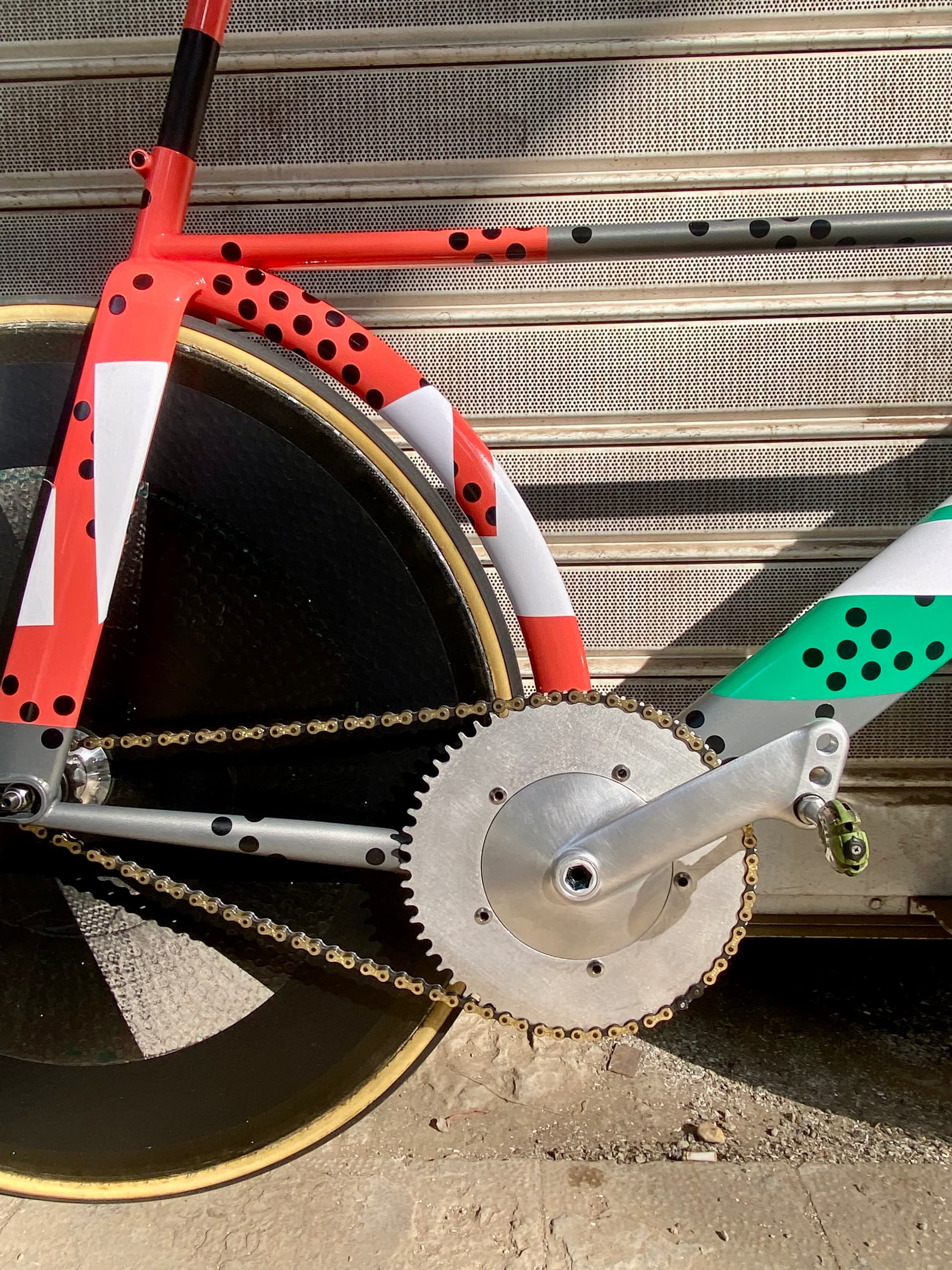

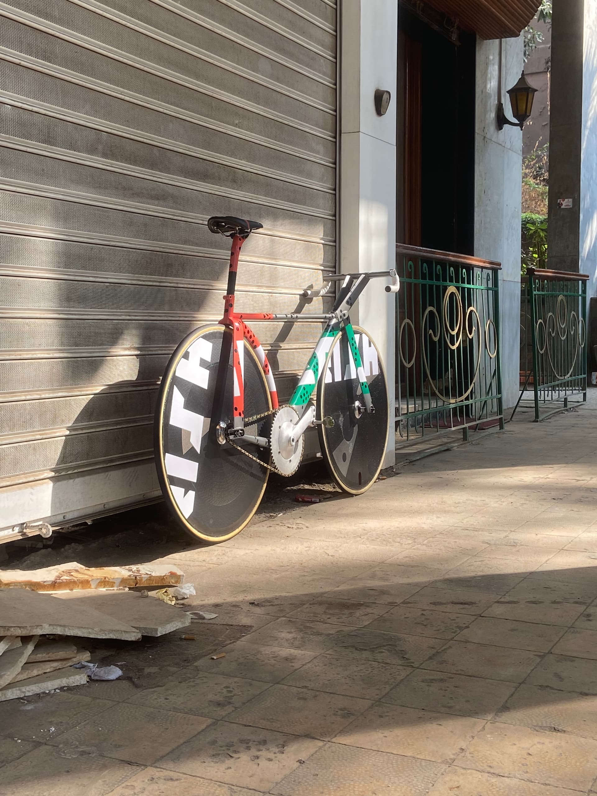

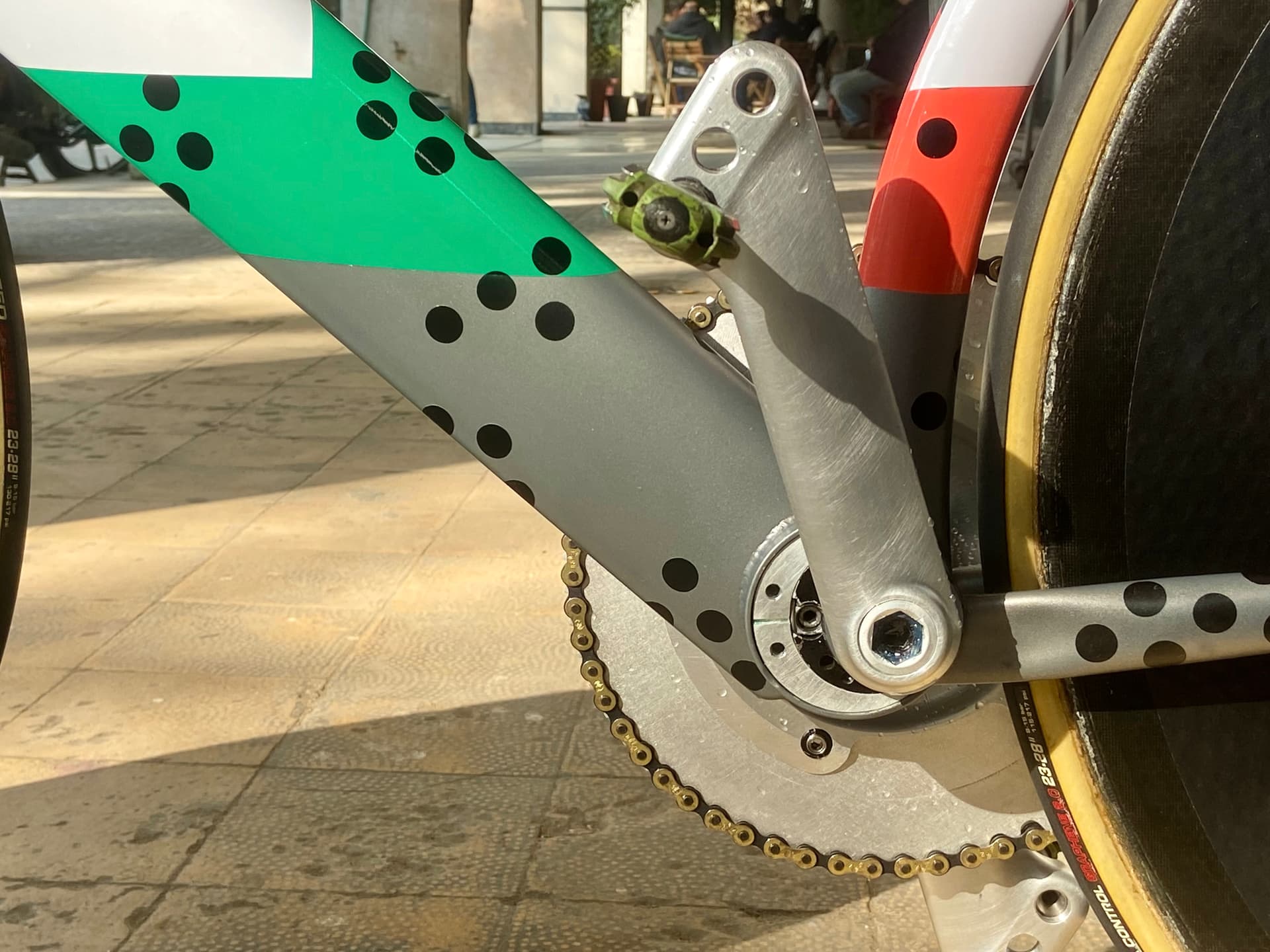

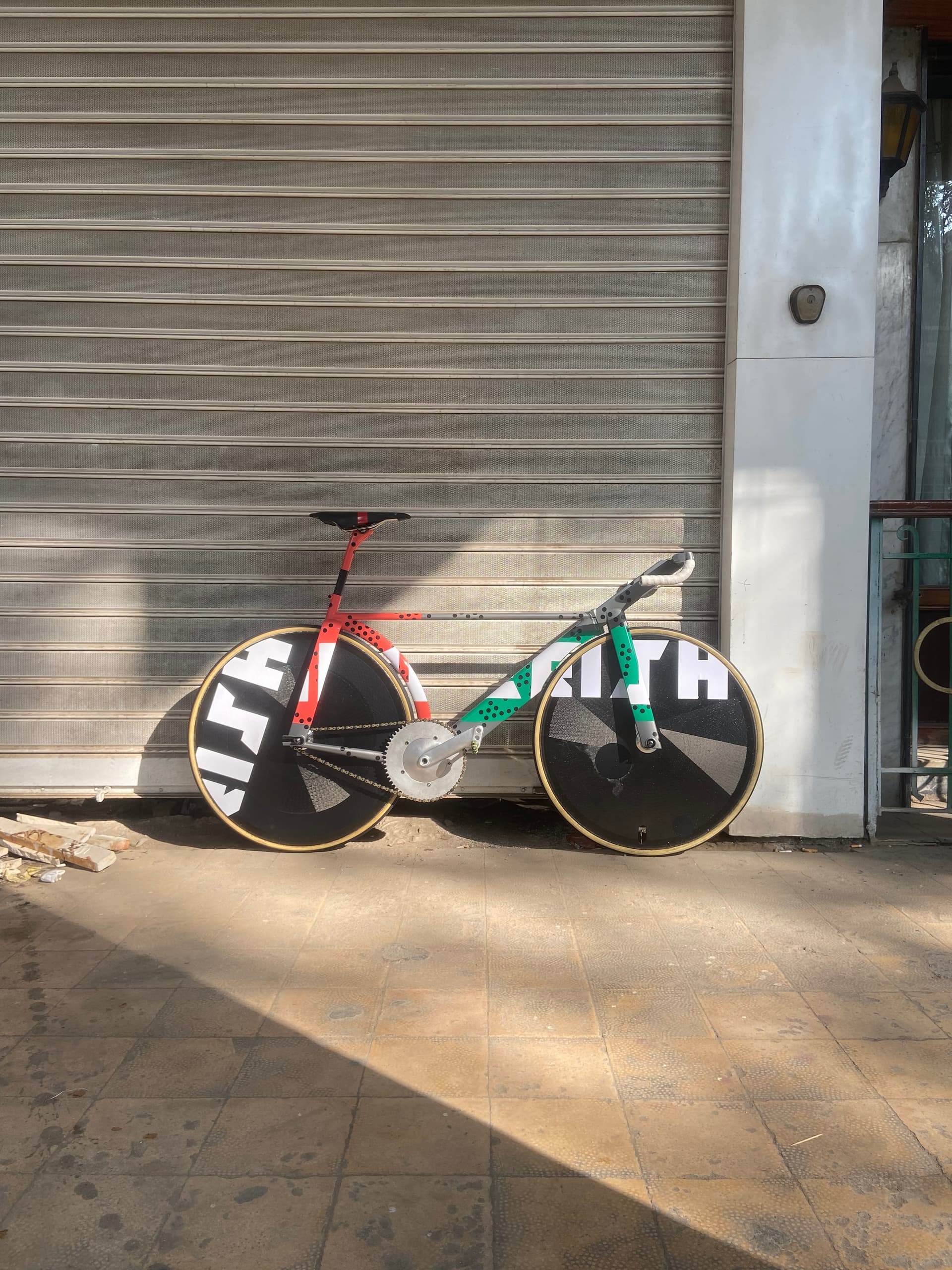

since then, I got hands on a bb, made some decals (the vinyl I could get is terrible quality and is coming off) and put the fancy wheels on, though i’m waiting now on a delivery of tubular glue.
anyway.
here’s some pics of it as it sits. the disc axles are interchangeable and here ive managed to get the front and rear wheels in the wrong places, and the front wheel inside out so the decals don’t line up anyway, but hell.
NB: bb30 spline details over on the BB30 spline thread
