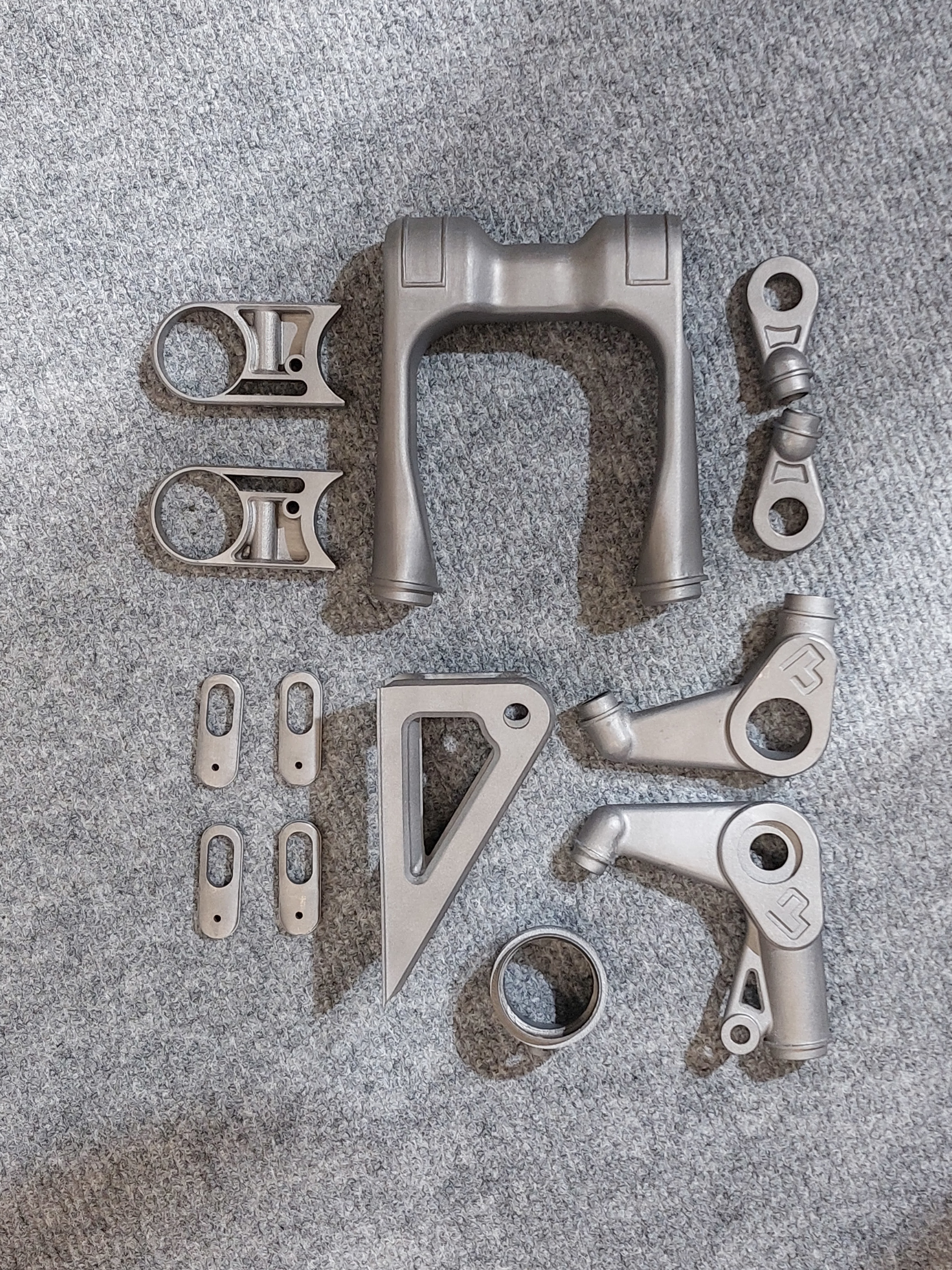

You’re more than welcome to drop the workshop in Wijchen, the Netherlands and check out our UDH dropouts. These are stainless steel, but a titanium full suspension is being built and we are working on a titanium UDH compatible gravelbike.

Reminds me of the dropout design shared by @DEVLINCC right at the start of this thread. Worth a re-post I reckon. Seems like plate style UDH dropouts consistently give off a much cleaner look than hooded ones, especially on road/gravel bikes with thinner stays.
Looks like a flexstay xc build coming up.
Sounds interesting! Any guestimate on the release date for the titanium gravelbike ?
Early 2025 if all goes to plan, but we can do it faster if someone buys one. :wink:
