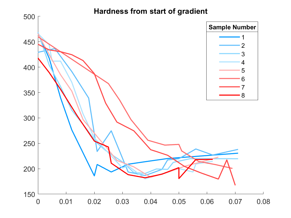

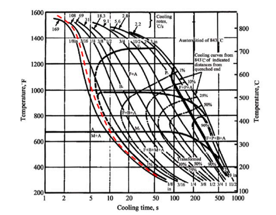

The aim: To study the effect of heat input on fracture resistance. This was done by testing welds made under a range of preheat conditions (with a cooled or heated jig) to change the cooling rate. It’s visual effect on the welds is seen in the picture below. Due to the different preheats, the only way to achieve similar welds was to approximate weld size and travel speed by foot pedal. A range of 0-275C preheats was done, with 8 samples total spread in between. 312 filler was used, which made the etching portion of the project fruitless. Dog Bones were EDM cut and tensile tested, and the remaining faces were mounted for etching and hardness testing. The hardness and tensile testing results are shown here. All dogbones broke ~2mm away from the toe of the weld, except for two samples that did not have complete fusion and fractured through the middle. No welds fractured “at the toe”, which was the failure mode I was aiming to gather data on. I think a fatigue testing scenario with a stiff, notched tubing sample would have to be used to get that.

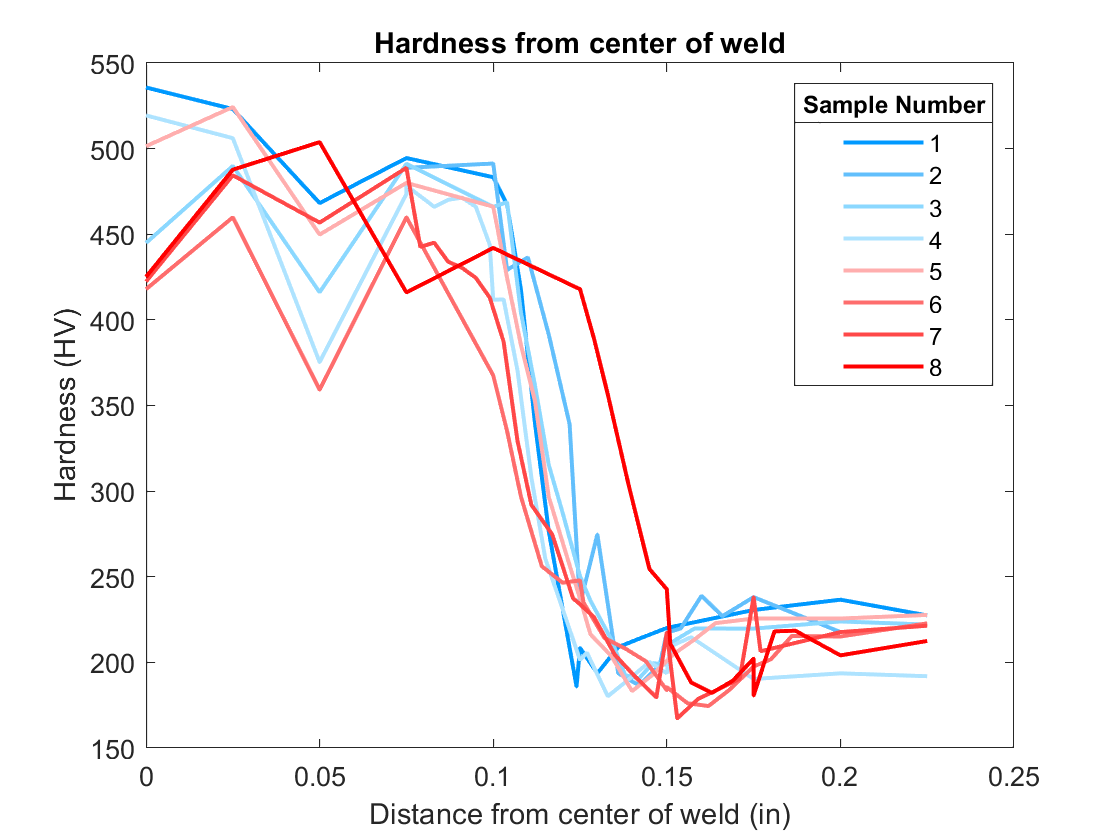

The Hardness testing was done on the Vickers micro scale, with a micrometer table so increments of 3x indentation widths could be made. The “interesting” location is right at the change between hard and back to base metal. This change in hardness starts beyond the weld metal, substantially into the HAZ. A full graph and zoomed in graph is shown below to highlight the trend. For all graphs, blue is the lowest preheat, and red is the highest, and the range between. From this its seen that the highest hardness and lowest hardness are similar in magnitude, but the gradient decreases with increasing preheat.

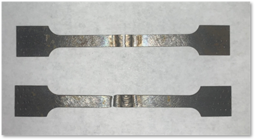

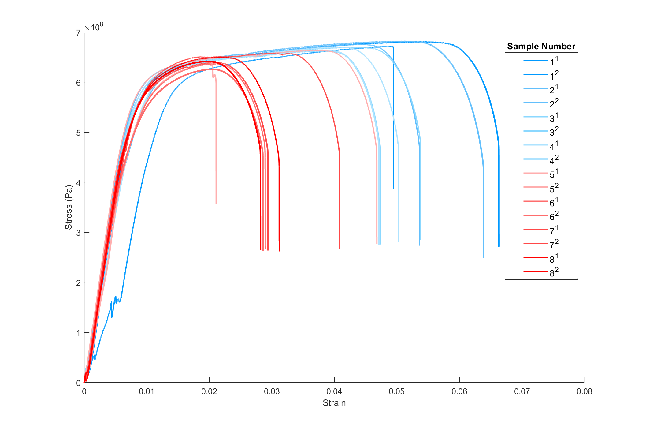

Tensile testing was done on two samples from each weld. The two samples that broke in the middle are the ones with abrupt endings, and the first sample slipped in the jaws so its start is shifted. Increasing preheat strongly correlates with decrease in toughness. All samples still yielded at the “same” stress, and all plastically deformed outside of the weld.
These results are quite in line with what I expected of a “normal” plastic fracture mode. Grain size strengthening is a dominant mechanism in normalized tubing, which must share a significant overlap with the fancy “air hardening” tubing that is sold. These grains increase in size in the HAZ, decreasing the strength and causing the plastic deformation and failure to occur there. The harder fusion and weld metal zones most likely have cooling rates quick enough or shrinking stress high enough (or combination) to cause martensitic phase formation, as they are significantly higher than the underlying metal. The 312 filler also solidifies hard, but more likely due to precipitation of carbides as it remains single phase austenite. The martensite phase is famously brittle, and is what is warned about when welding thicker 4130, and is shown in the CCT diagram below. Unfortunately, very little insight could be gathered from those in “academia” with higher credentials, though I have on two occasions been told by metals professors that aluminum is not weldable unless by friction welding, so I suppose that would have been too much to ask for. From literature review on the subject it is clear that fracture mechanics in welding is difficult to conclusively determine. Therefore, a qualitative, experimental type of direction, with some ground rules in metallurgy, seems like the most valuable way to go about increasing the knowledge.

The results were a bit counterintuitive to what I expected. I assumed a heat soak at 400c would have let the grains chill out as the weld cooled. Instead, it seemed to have the opposite effect.
A few questions:
  • did you do a control sample w/o any welds to test the nominal stress and strain?
  • Why do you think the dogbone failed so far away from the weld?
  • To me, it looked like there was some thinning and shrinking close to weld bead. Do you think that had some effect on the “true stress and strain”?

We did not, unfortunately, test a control sample. That being said, it can be compared to known values for 4130, as stress is normalized to cross-sectional area of the sample. It was compared in the report, where yield stress, ultimate stress were nearly equal, but the standard value showed much higher elongation, 25% vs the highest achieved 6.5% here. The elongation could be affected somewhat by our dogbone geometry, but the trend of decreasing elongation with increasing weld heat input carries, so it makes sense.
The dogbone fails in the coarse grain area, where it is weakened by the heat. Just to be clear, by “at the toe” I mean immediately at the toe, where as these fail ~2mm from the toe.
The tensile test shown here is referred to as engineering stress and strain, where the force is divided by the original cross section. This is usually the standard, though true stress and strain is sometimes used, and the instantaneous cross section has to be accounted for. The thinning is referred to as necking, and is a key way in determining whether something fails with a brittle or ductile fracture mode. The ductile mode absorbs a lot of energy and in a sense “gives a warning” before failing, which in most terms is preferable.
