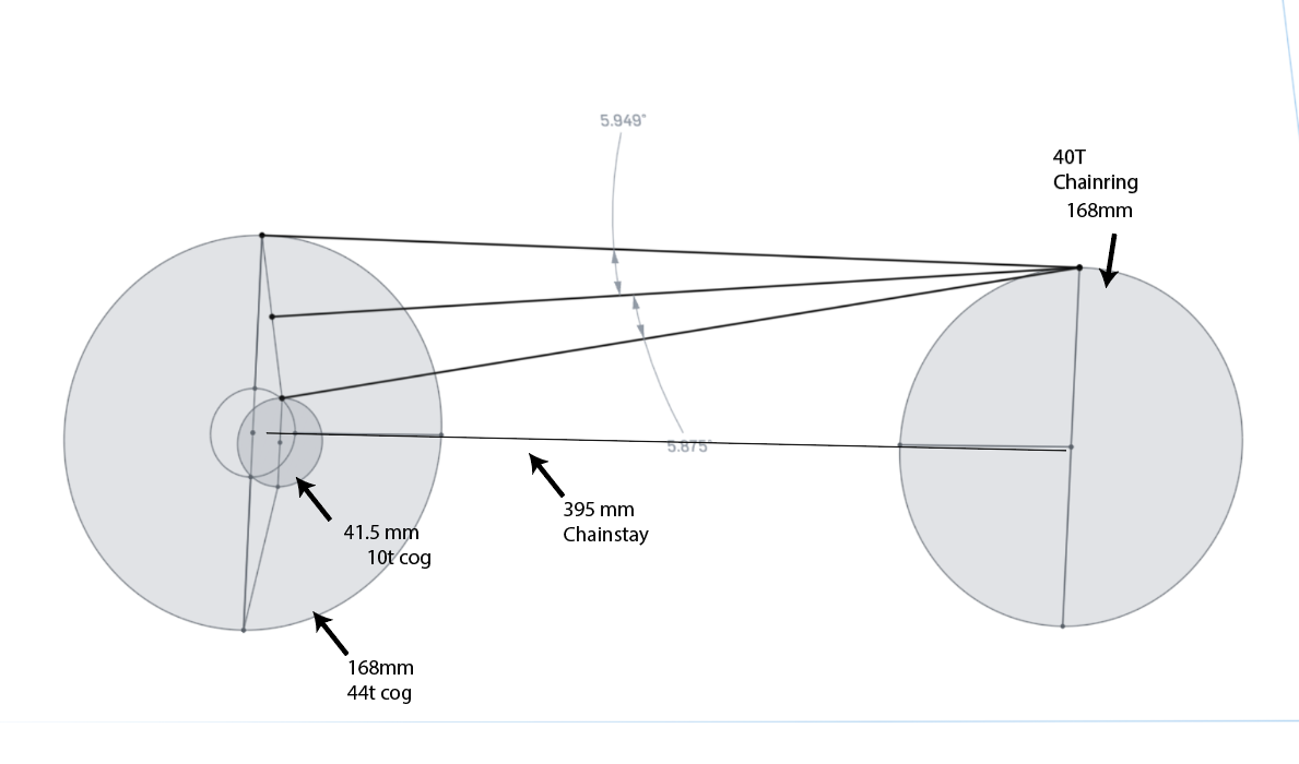

What am I missing? Why haven't I seen this before?
Criticism isn’t always easy to hear, but I think it’s worth keeping it constructive.

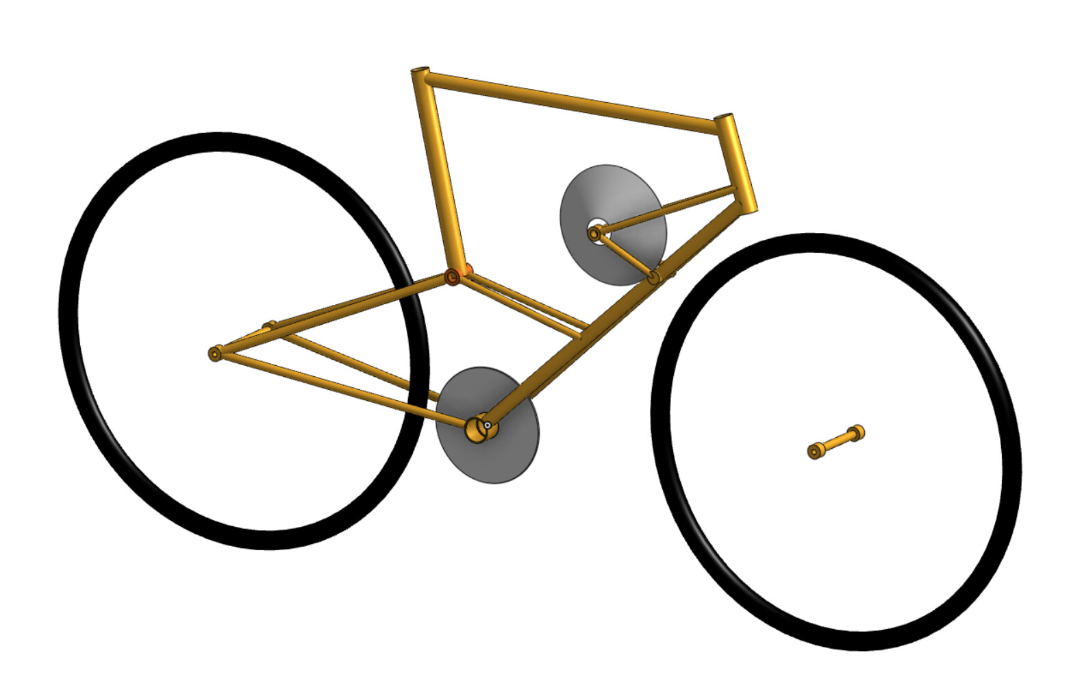

Though I’m late to the pile-on, I see that building this design accurately would be extremely difficult. Especially chainring between split bb setup.
OP, what tube to tube fabrication experience do you have?

I think the CAD, aesthetics, and concept is great. IMO, packing the drivetrain is the crux of this challenge and might take a few iterations to get right. But I don’t see why it wouldn’t work.

I agree with @anon91558591 that gearbox systems largely solve the problems you’re concerned with. The big issue with those systems, is the inability to shift under any load. If you can solve that then you’ll have something really valuable.

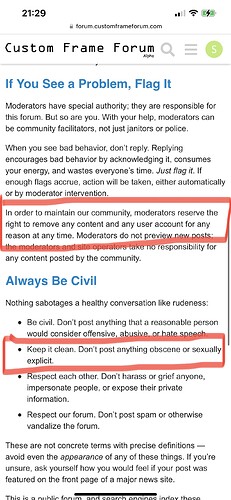

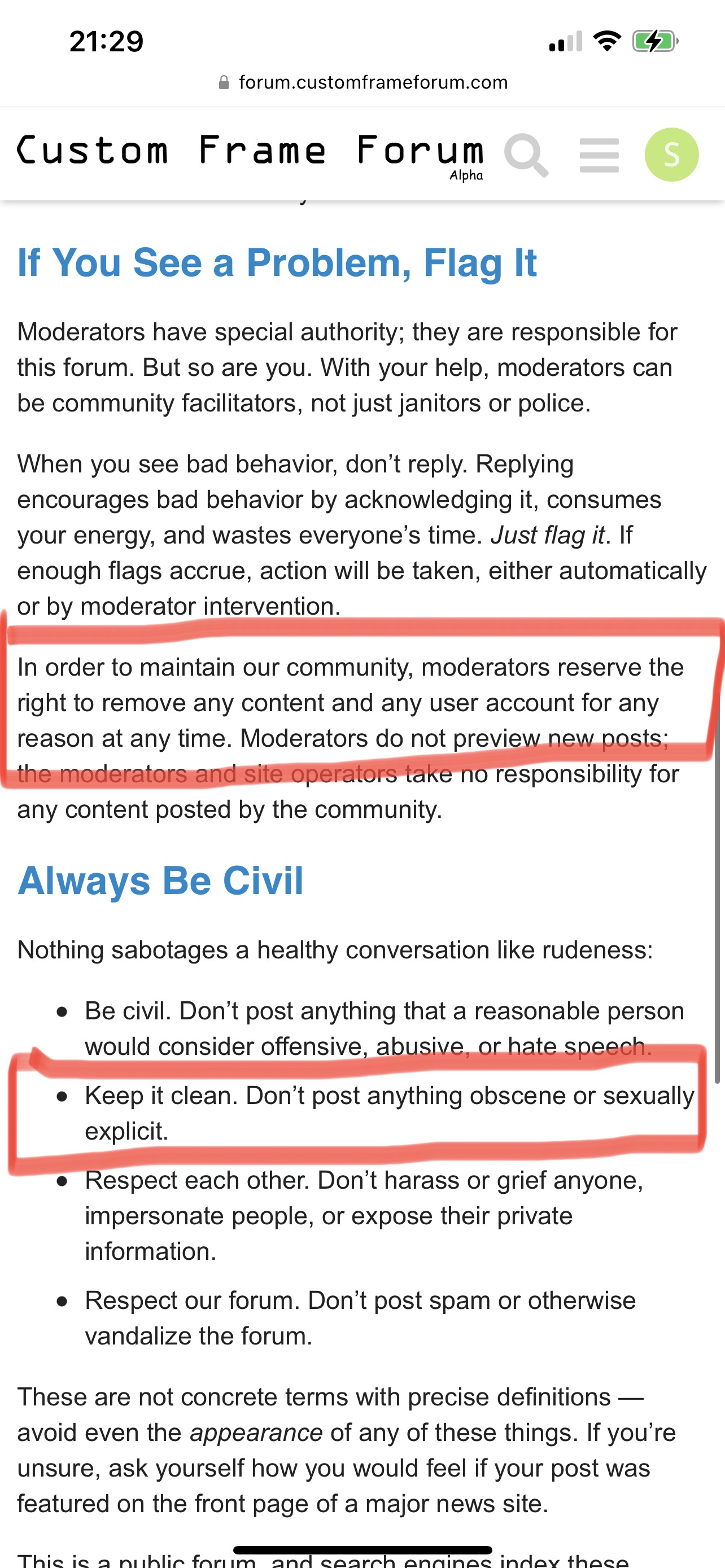

Moderator here. I have seen the deleted content and agree it should have been deleted. If I had seen it first, I would have deleted it too. The community guidelines very clearly state that forum moderation can and will happen at any time especially in instance of gross and unnecessary commentary.
On a personal note, content as such is othering to people who are not part of ye old boys club. This forum is meant to be a space that is educational, inclusive, welcoming to newcomers to this community. This is a classic example of ~it’s just a joke~ ~we’re just kidding around~ but I would ask you to really just take five seconds to objectively think about it from a perspective other than your own and understand why moderation of this type is important.

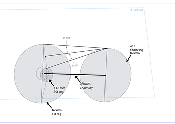

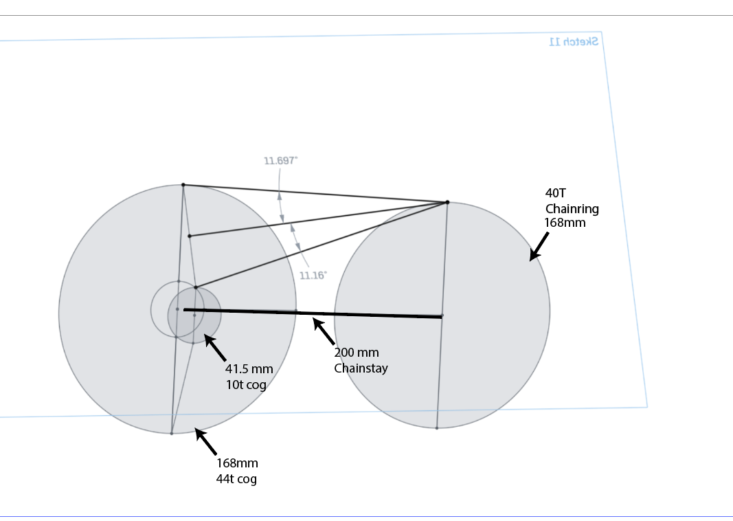

Chain angle appears to almost double on utilisation of that space. I modeled a 200mm chainstay which only offers 23mm of clearance on the ring+ cassette + not enough clearance on the tire so I’d have to resize things, change geo etc. In any case, I think based on what I’ve heard about 12 speed drivetrains being difficult to adjust, i’m pretty sure getting this close is a non-starter for shifting performance.

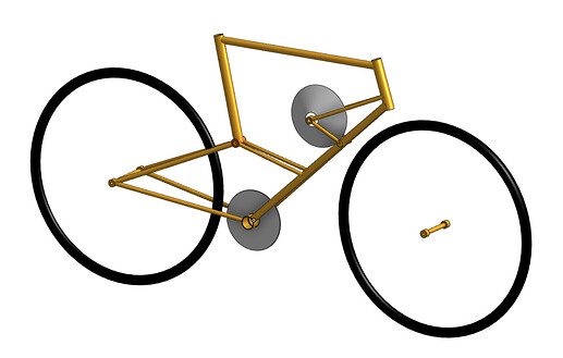

Did a few short revisions today, and nothing else really made sense so I’m back to the OP design, but with some modifications to move cassette lower (still on 395mm fake chainstay axis). Based on the feedback above, I took to heart the idea of knee/calf/thigh interference, and moved the cassette as far forward as possible. Did some mockups of tubes on the bike I modeled this geo after, design after and in this new position it seems to be much more clear that no impacts to pedalling will occur.
I had to make some bad rounded tubes to shoot out the struts, but I assume the the final design will look much more organic and polished.
So, at this point, I’ve checked 12 speed drivetrain clearance and I think it’s ready for moe barbequing on the forums. I don’t think anything is really different here, so no need for anyone to provide any additional feedback. I think it’s time for me to learn some proper CAD and get some lug/joints designed.

This is an evolution of a 1x drivetrain location. The goal is to keep using existing drivetrains but change the location to solve aforementioned problems.

Let’s see the fixtures you intend to use to build this.
That’s a bit cart before the horse, it doesn’t make sense that a proprietary fixture would be designed or in place if the design is still up in the air. It’s a typical process to get a drawing finalized and then backwards-engineer a fixture as needed, ask any builder who does full suspension design/fabrication and has to build linkages, shock mounts, and a bunch of sub-assemblies.
This design is cart before horse

I’m definitely going to be backwards designing these to work.
@Nick

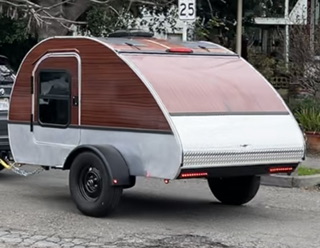

Just wrapped up a teardrop trailer build with my wife and father in law. Built it from scratch square tubing, we even built the base. We were able to cut square tubes and bend them to from radiii for the doors, frame and hatch, so I’m sure I can figure out how to line up some steel tubes.
