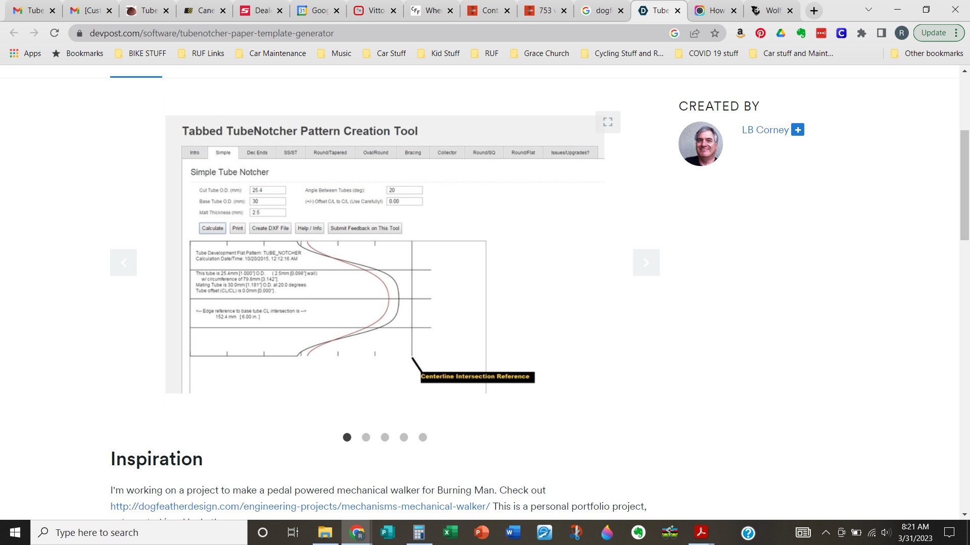

Daniel_Y - attached are what I could find. I never took a screen shot, only saved a few templates.
The tabs show the options he had, and each one had a visual example and explanation of how to use it. There was one specifically for SS to ST joint that was AMAZING and way simpler than trying to get the many data points (which aren’t ever published) for the SS tubing in BikeCAD. I could describe dog feather’s inputs for that if needed in more detail…
the site was DogFeatherDesign.com, by L.B. Corney
I hope this helps.
dog-feather-ex-2
dog-feather-example
dog-feather-tabs
