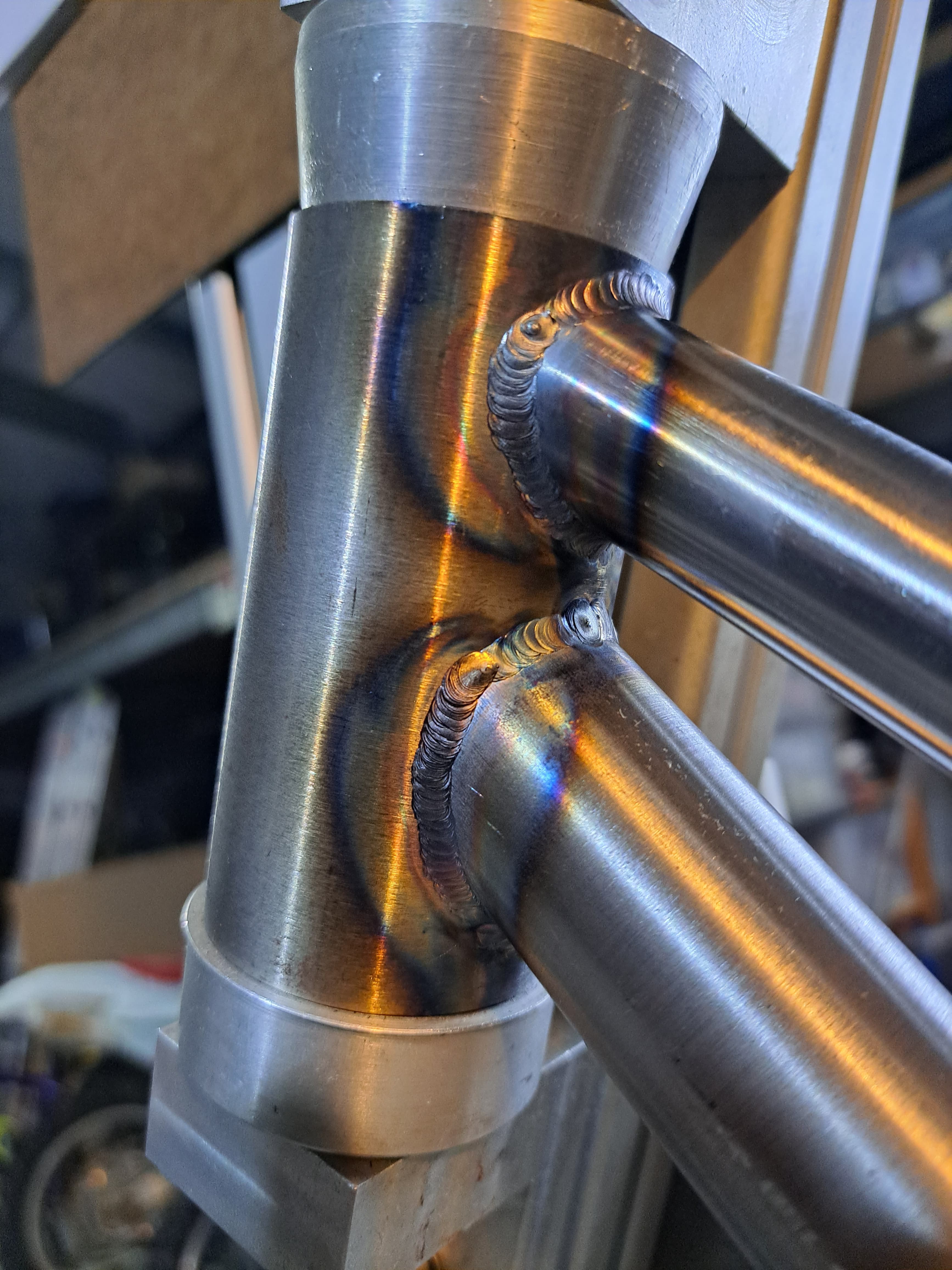

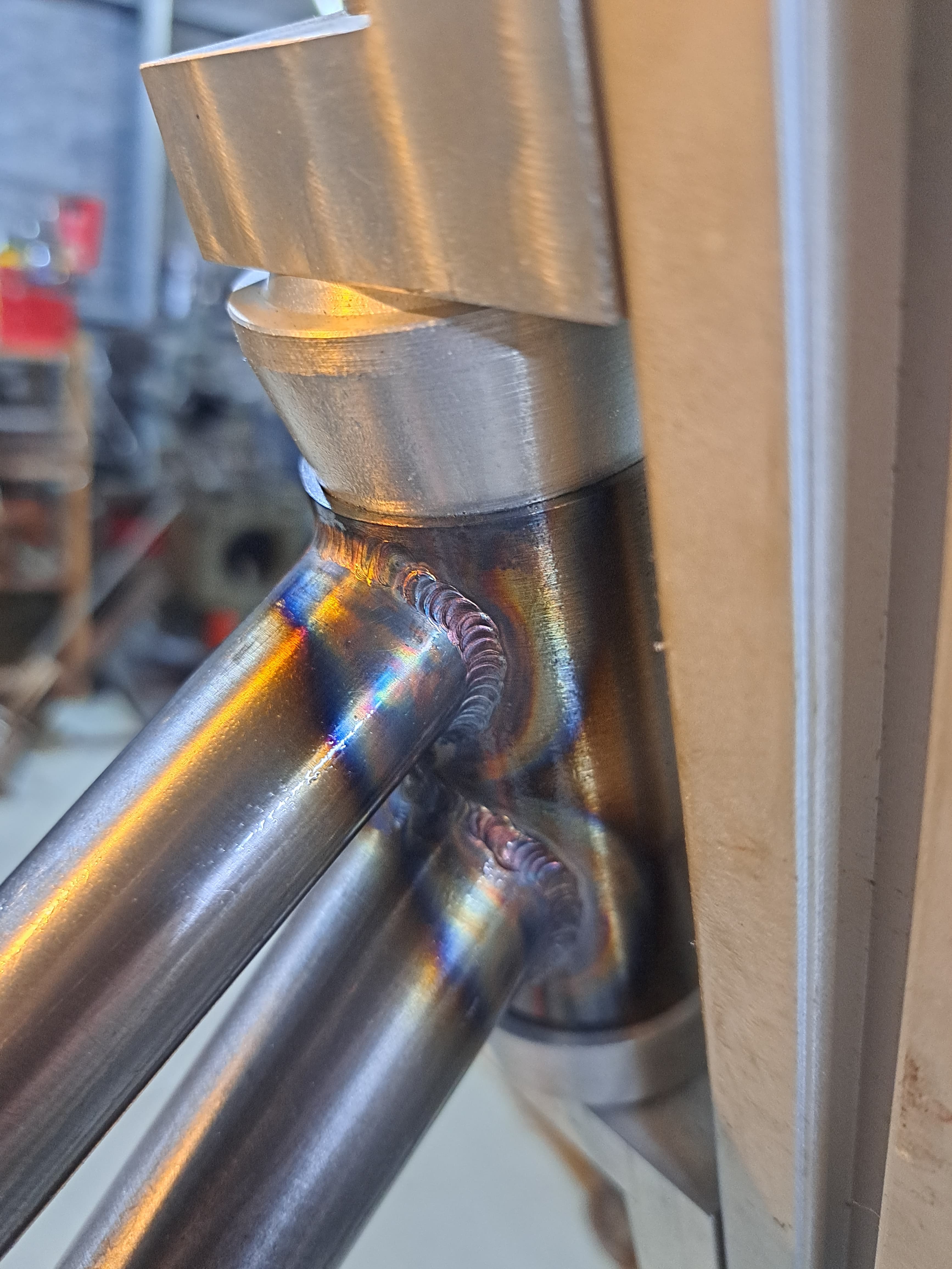

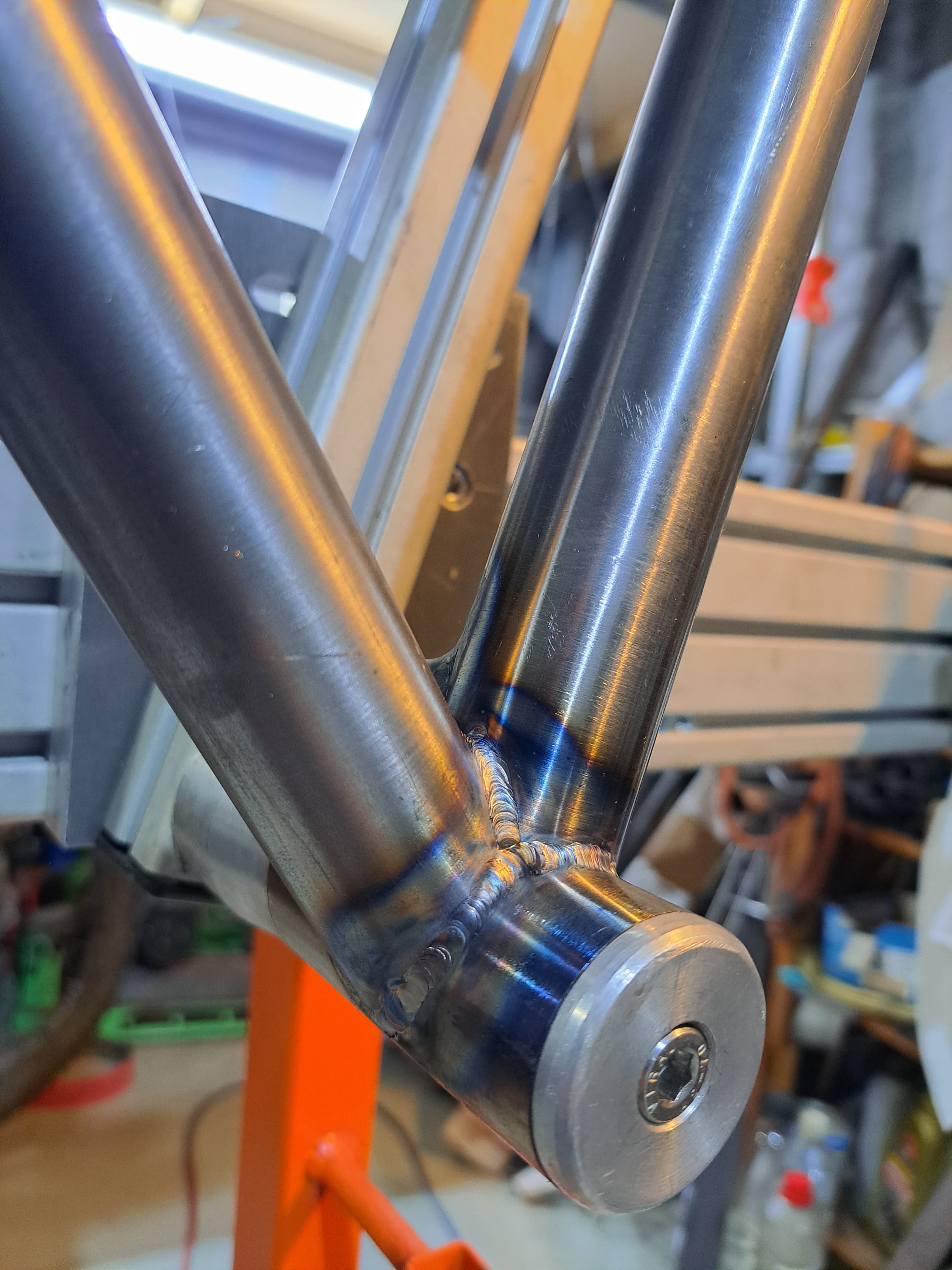

Progress report:
Functional Tig pedal is much better. Still figuring out the stops but starts are good and if I manage to get comfy some of the beads are looking pretty good imo
