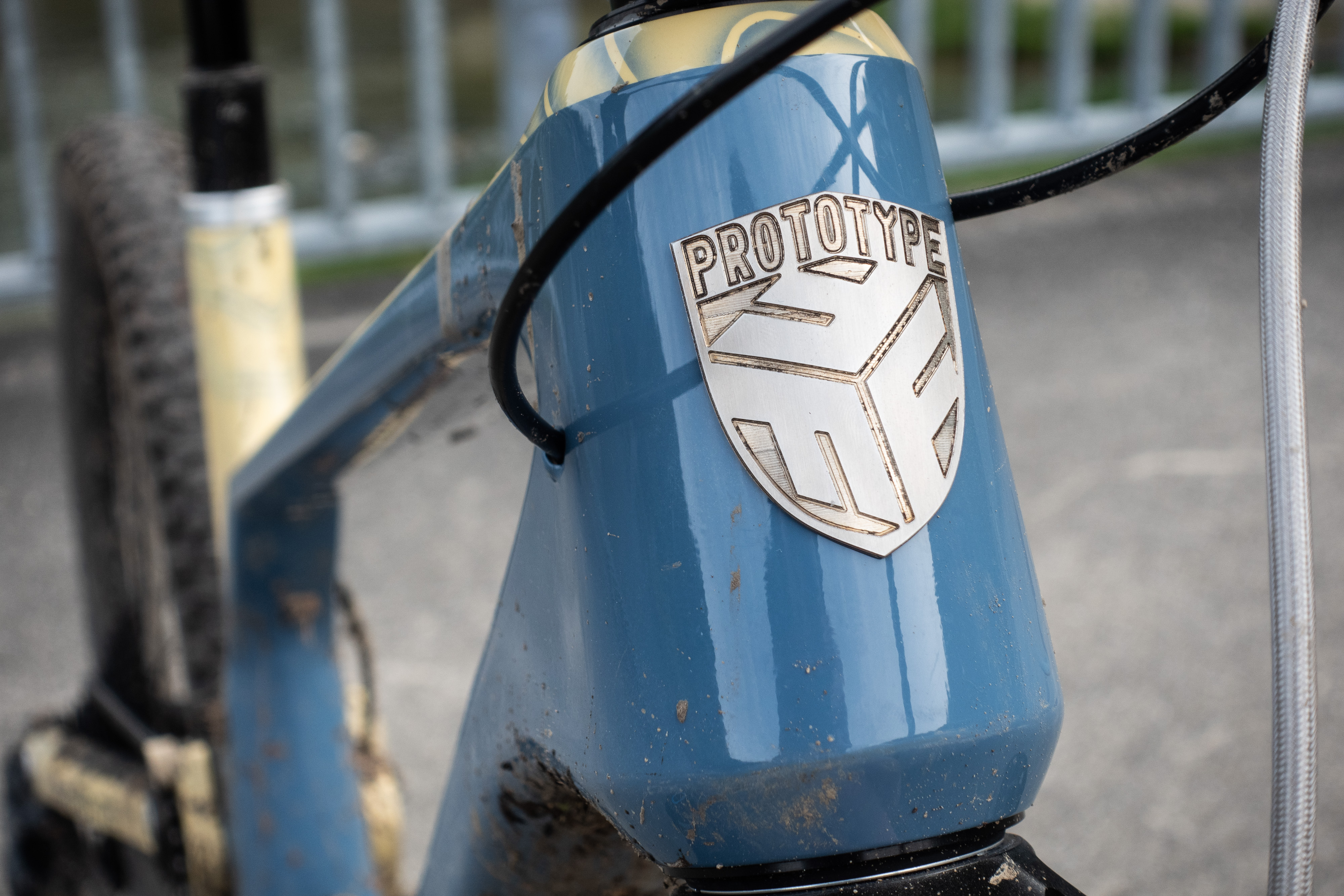

After a couple of rides I can share that I am more than stoked on the result! There is the initial euphoria and I am sure there are things that will pop up over time, but for now I am more than happy with the bike. The biggest concern I had was probably the high anti-dive values, but at least in the muddy, low-traction conditions we have here at the moment, it is not a concern at all. I had to machine a slightly longer idler pulley axle to improve the dirt clearance. It gets pretty caked in dirt. This messes with the chain line by a mm and results in a noisier idler, but oh well.
I am also working on a small fender that should help the situation.
It is definetly a bit of a handfull on the uphills, but yesterdays ride felt still very manageable on the way up and I am looking forward for some 1500+m of elevation gain rides. And on the downs it feels amazingly stable and planted. As of now I did not fiddle too much with any suspension settings, so it can only get better.
So not really sure how to put all of this in words, but go ahead if you have any questions!

So good! That is absolutely amazing
