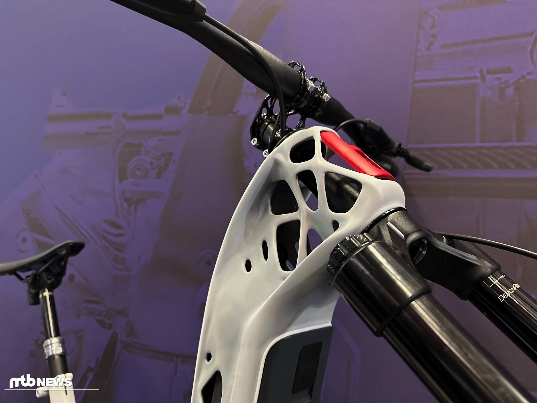

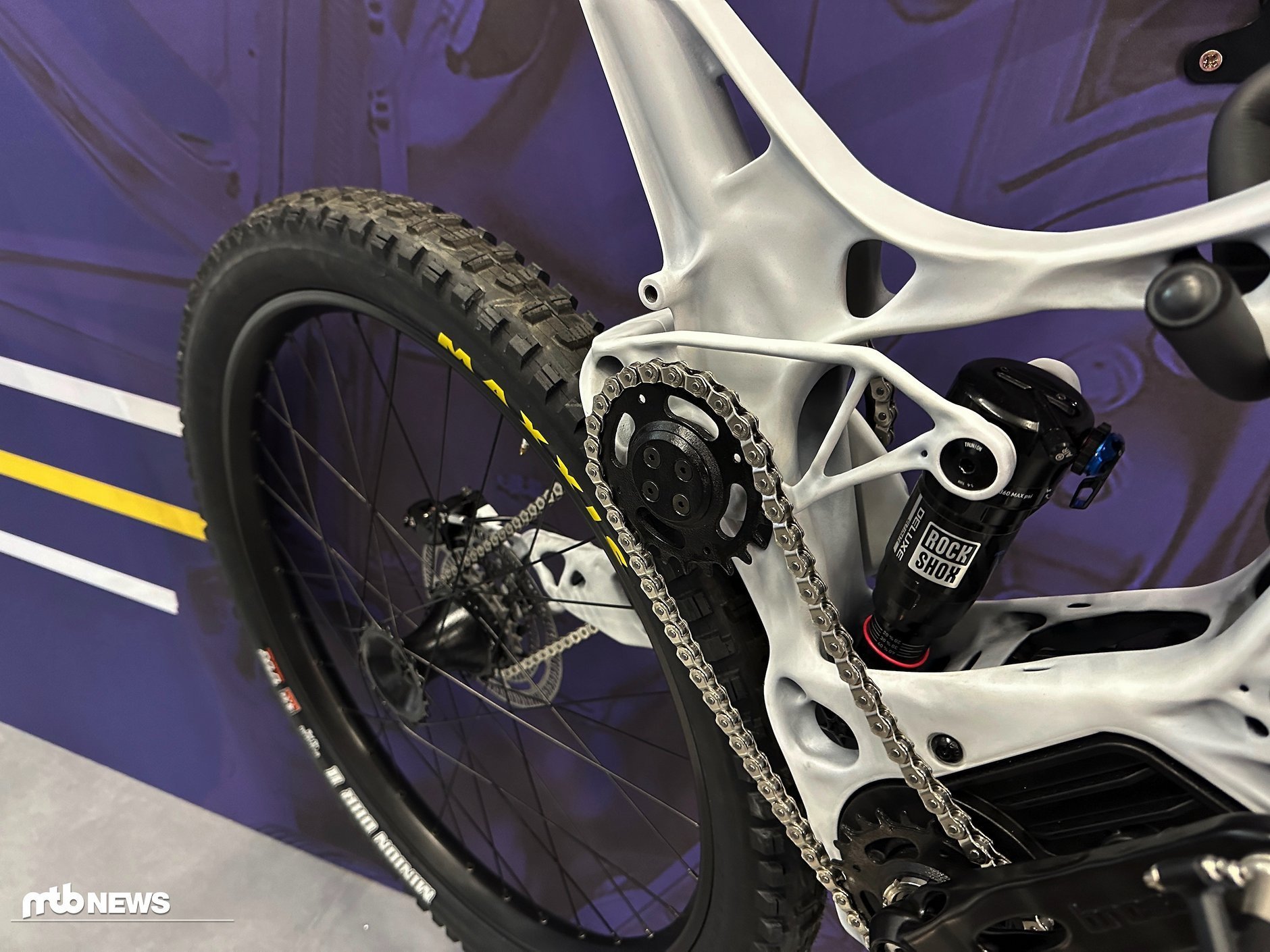

This thing is wild
That stem is terrifying!
The whole bike: “Computer, generate all the topology.”
Ha! I didn’t even notice the stem.
Stem looks like an even more sketchy version of the mythos one. :scream:
As for the frame - I guess it’s an exercise in what could be done - but I can’t help wondering how much it weighs when it’s full of mud… :thinking:
At least it has a rack mount for bikepacking.
Love everything except the transition from massive headtube to “skinny” forks, I would have done a front fork in the same way the frame is done.
Having said that: wild indeed.
Took long enough for the bike industry to make a full-suspension E-mixte!

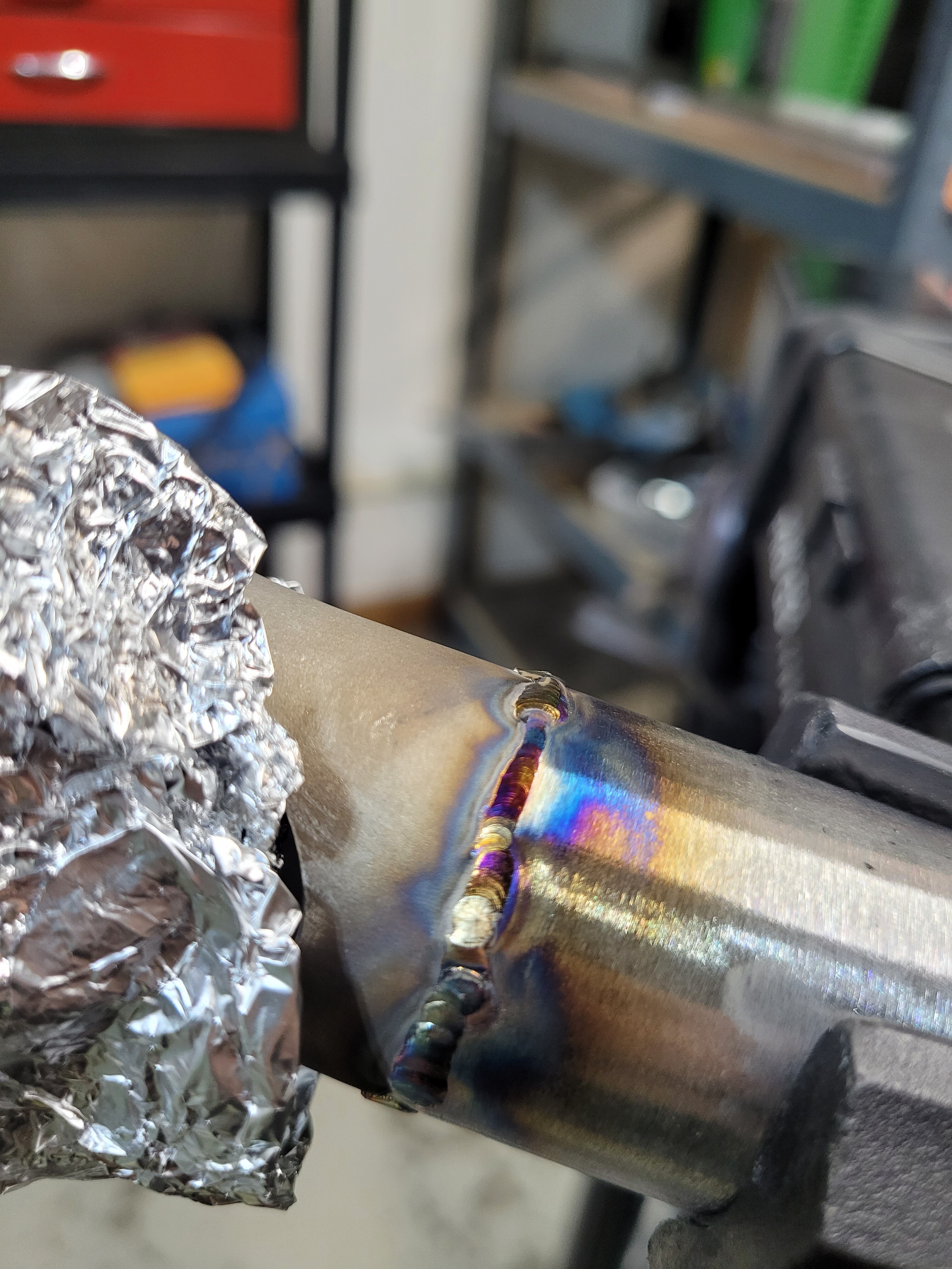

I finally got around to welding up my first article frame. I am certainly not an expert welder but this joint gave me more trouble than I expected.
I am curious what other’s process is for welding stainless printed butt joints to 4130 tubing is, mainly:
  • Do you usually do a fusion weld or add filler?
I was having trouble adding the filler but I think I was also too cold on most of the weld. The fusion pass seemed to work quite a bit better.
That looks very cold. Torch angle has a huge effect on bead consistency and shape when joining a printed part to a tube. What are your settings? What filler and size? Fusion will not be strong enough for that joint especially considering that you are joining dissimilar metals.
