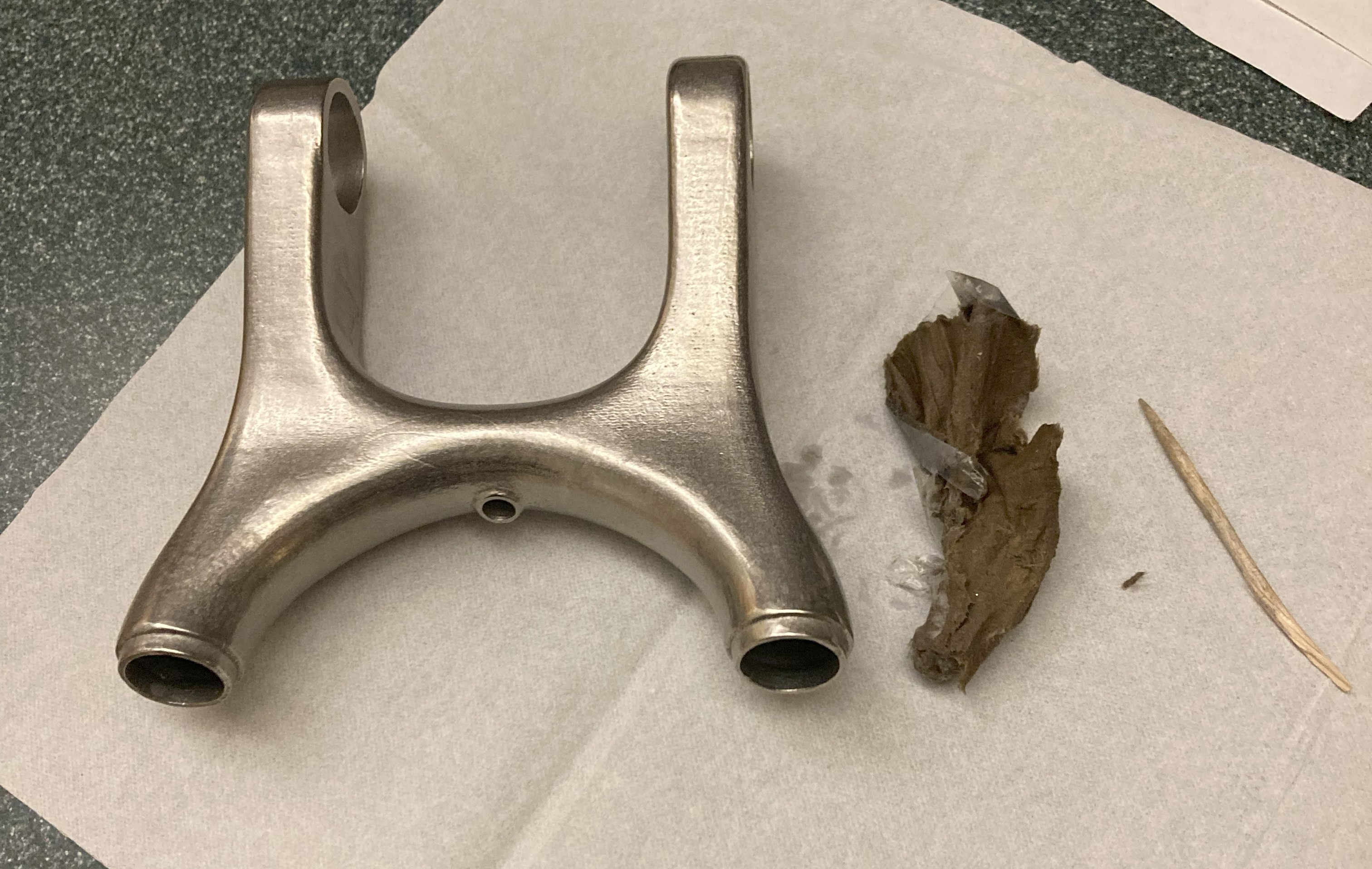

I recently received some 3D-printed parts from In3dtec and was surprised to hear metal shavings rattling inside some of the metal parts. After poking around inside the parts with a toothpick, I managed to extract a huge chunk of a rubbery, play-doh-like substance that was filled with metal shavings.
I’m assuming this is a remnant of the stone-tumbling process service offered by In3dtec, which I should not have selected. I’m also guessing tumbling remnants are still in the parts and am not confident I can successfully extract them before welding.
I’m curious if anyone else has encountered similar issues and hope others can learn from my mistake. I reached out to In3dtec but have not gotten a response yet.

Was it a large stone? or from media blasting?
Having worked in a 3D printing company, I know that there is a lot of trial and error in printing those complex hollow parts. The printer manufacturers and print fabs want you to believe everything is possible. It usually takes some iteration and back and forth to orient the part, support material, and post-processing.
That part looks great, though! My guess is that the rattly sounds are from the print tech trying to remove the internal supports. An internal lattice would have avoided that problem (no supports to remove)

Thanks, Daniel! Great points about the print orientation / supports - I didn’t communicate with In3dtec about either of these and think this probably worked against me in this case.
Interestingly, the metal remnants that came out of the tubes seemed to look like the media used in needle polishing. There might be a disconnect between the finishing services In3dtec offers and the processes they actually use. I’m sure there is some internal support left in the prints but can’t hear anything rattling now!
If you don’t use a lattice internally there will be print supports inside they can not get at to remove. I had a discussion with In3dtec and in teh end I decided I was ok with the supports they couldn’t get to. Also be mindful of galleries that can trap both the sintered powder and the blasting media. For my rockers I allowed a hole that the hollow arms/chords could be emptied of the sintered powder. Did you actually request tumbling? I’ve only ever used sand and glass blasting. The glass blasting leaves a very good surface.

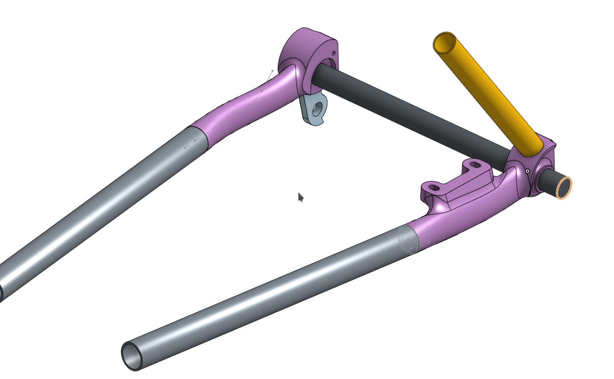

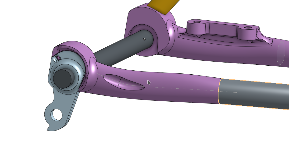

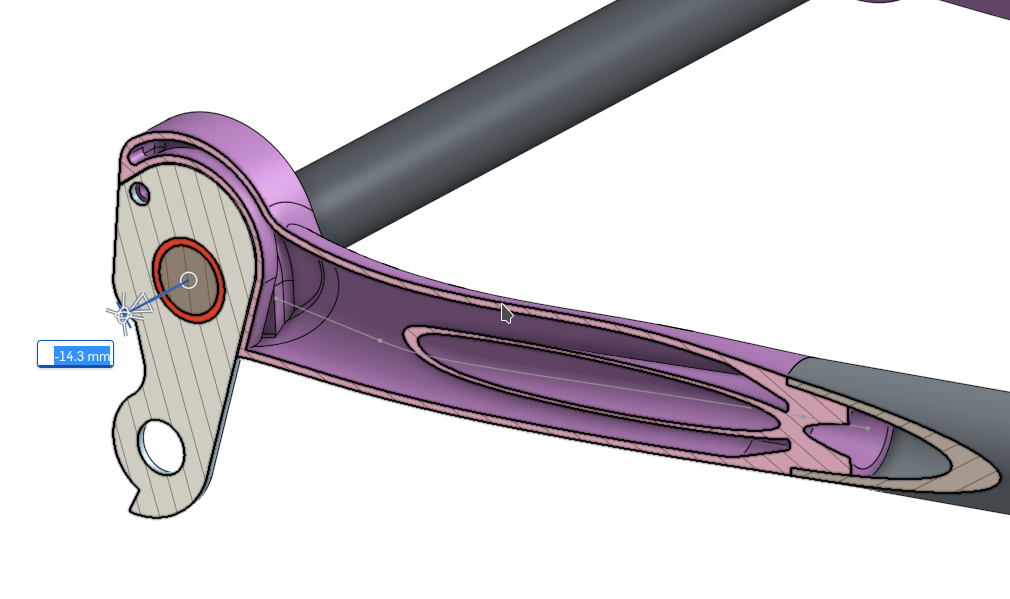

I made a first design attempt too, see the pictures below. The design was made in OnShape and is open source so everyone with OnShape access (which is free for individual use) can use it or develop it even further:
Has anyone some experience with 3d printing suppliers in Europe/Germany concerning quality and prices?
I forgot to post a link to the STL files:

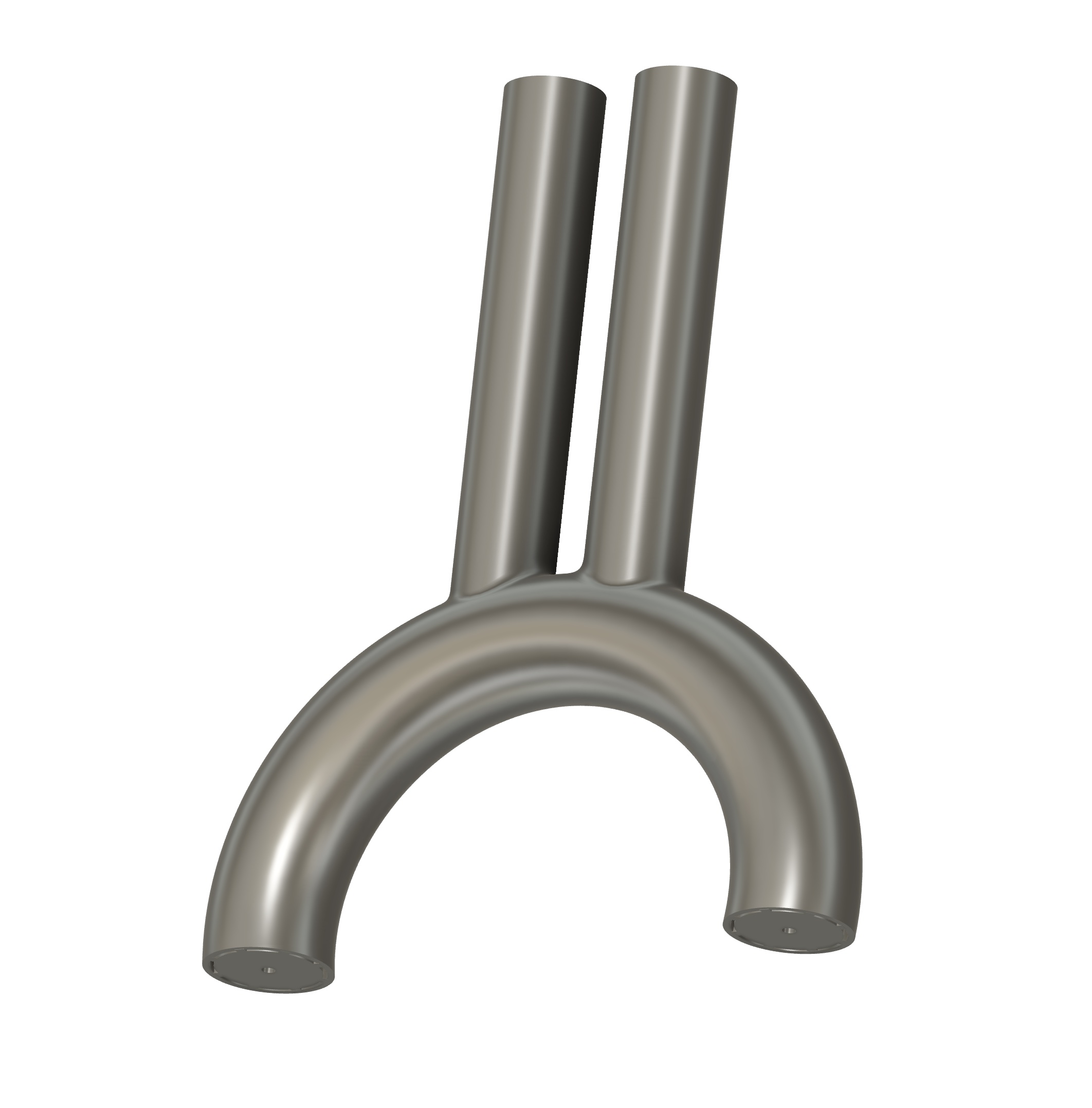

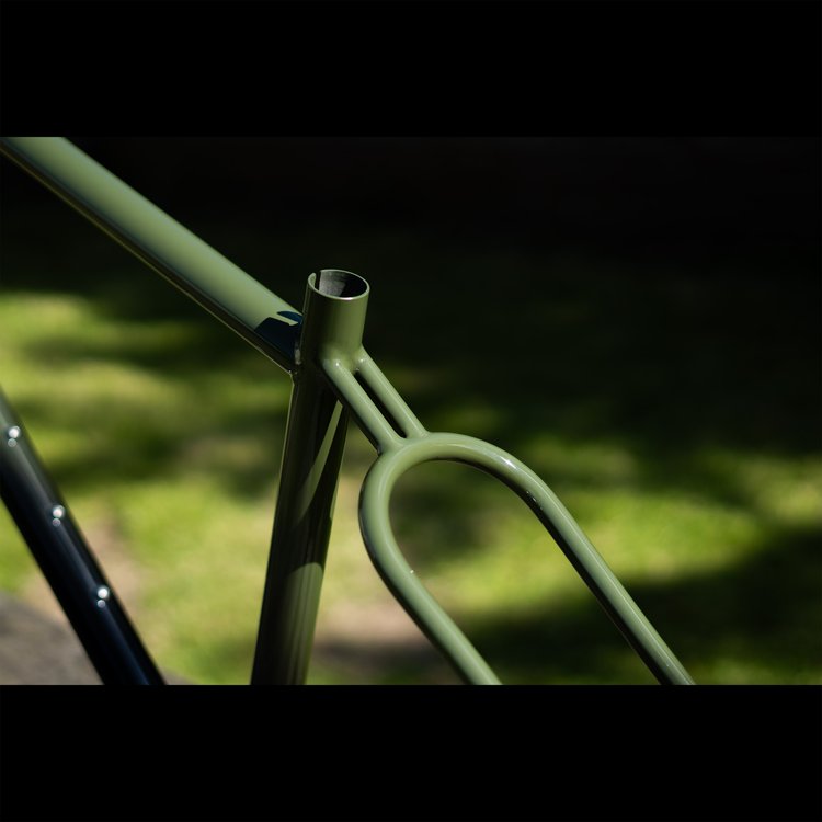

I’ve not looked at 3d printing for a couple of years but decided to have a look to see if I can find a solution to a current problem I have. I do a little treatment on seatstays that I call TwinBone, it’s like a wish bone but has 2 struts joining the stays and the ST. Anyway, I bend a loop stay and weld what I need to to get the final product. This is great with bigger clearance bikes but as I shoot for narrower tyres the CLR of the bend gets too small for me to bend the tubing consistently without deformation (this is using a mandrel bender). So I thought I’d price up a 3d printed part to see what kind of ballpark numbers we’re looking at.
I’ve not optimised this in anyway, it was really just a very quick model to get an idea of pricing. I uploaded my model to IN3DTEC and they’ve come back with a single unit price of $11 in 316L using SLM.
Does that sound right? I was really thinking I’d be looking at something 10 X that cost.
To give an idea of scale the model is based on 16mm diameter main tube with 14mm diameter struts.
Am I just really out of touch with pricing?
Cheers
Steven
What’s the weight?
oops double post
~ 120g
3DPBS charges € 0,60,- per gram printed stainless, which I found to be a fairly decent price. € 11,- for 120 grams does indeed seem to be pretty low. But for that price I would just order a couple and see what happens. :wink:
That is so cool. Love it
Yep. Tgat sounds about right. My swingarm Yokes cost me about US$180
