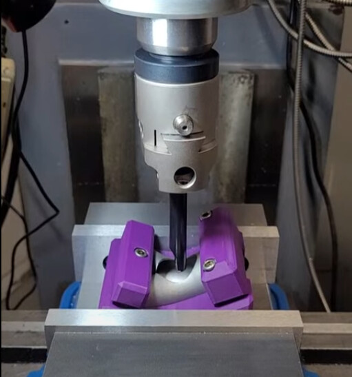

What is everyone’s process on printed holes?
These junctions have a thru hole for the seat post that sees some warping during printing. I have consistently had to open these hole with a boring bar to get the seat post to fit. The main material removal is from the back 1/3rd of the hole, which makes sense as that would be the portion sagging during print. I originally oversized these holes slightly hoping they would fit without rework.
I’m debating whether I should close these holes up ~0.5mm and just plan on cutting the seat tube hole for every frame. Is anyone else using similar junctions that could share some insight?
Cheers
I didn’t realize, but that is the benefit of designing the part without the seat stay section connected. We can just pry open the yoke to get it to slide over!
Haha I was wondering if that was the case for your parts. Good DFM!
