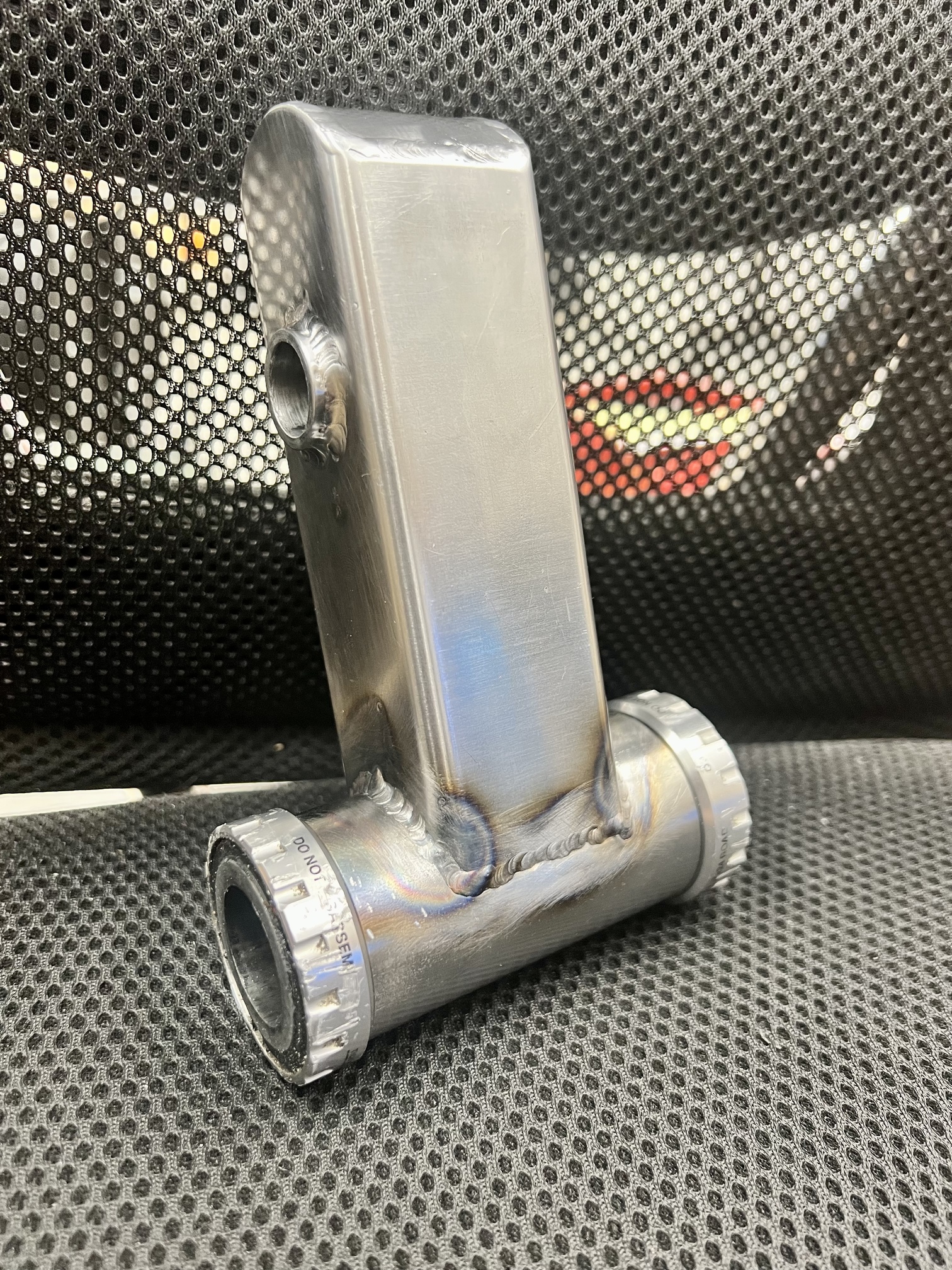

A little welding progress. Having hard time with lift arc finishing craters.
3 generation of welds. Getting better every time.

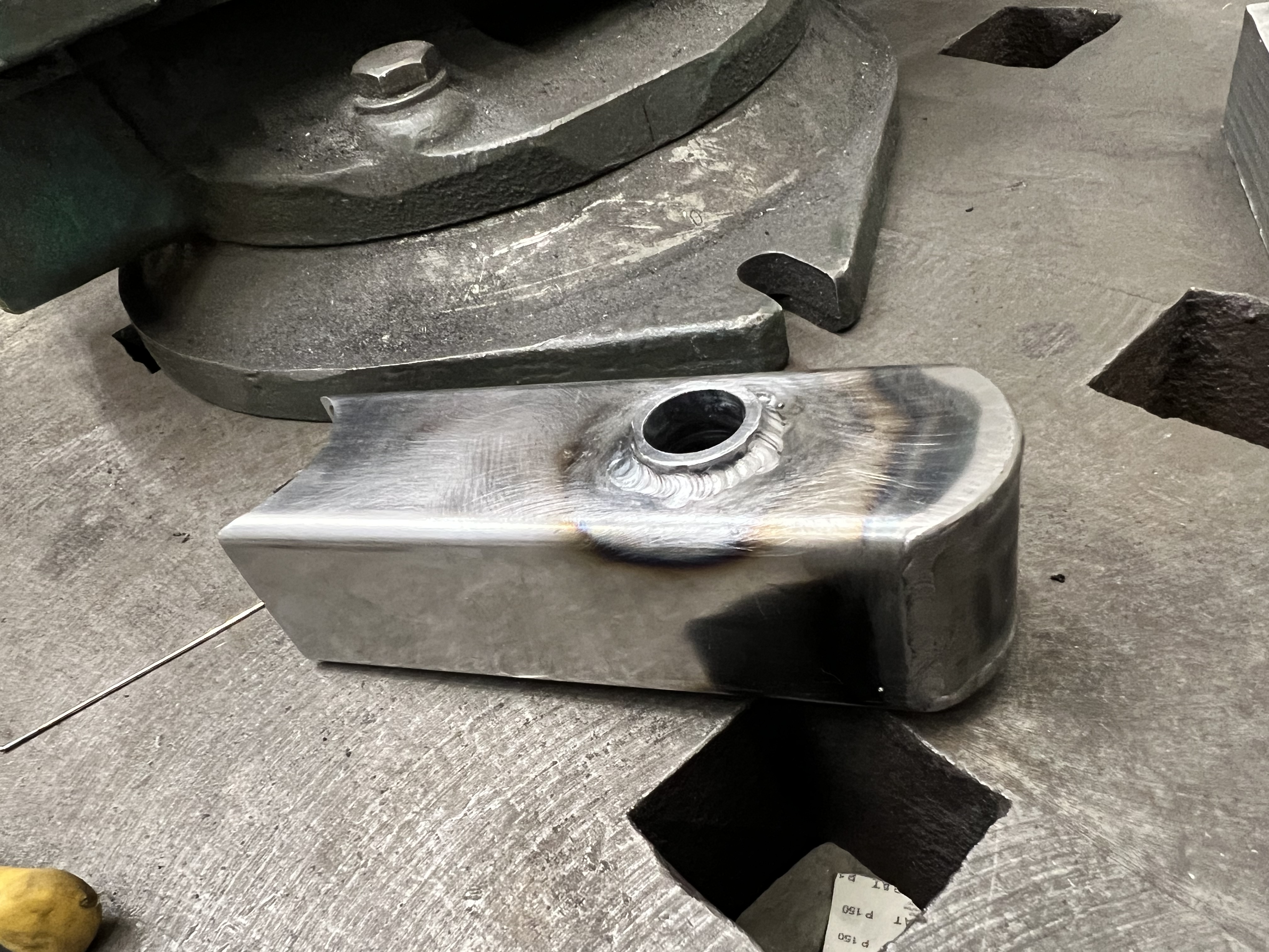

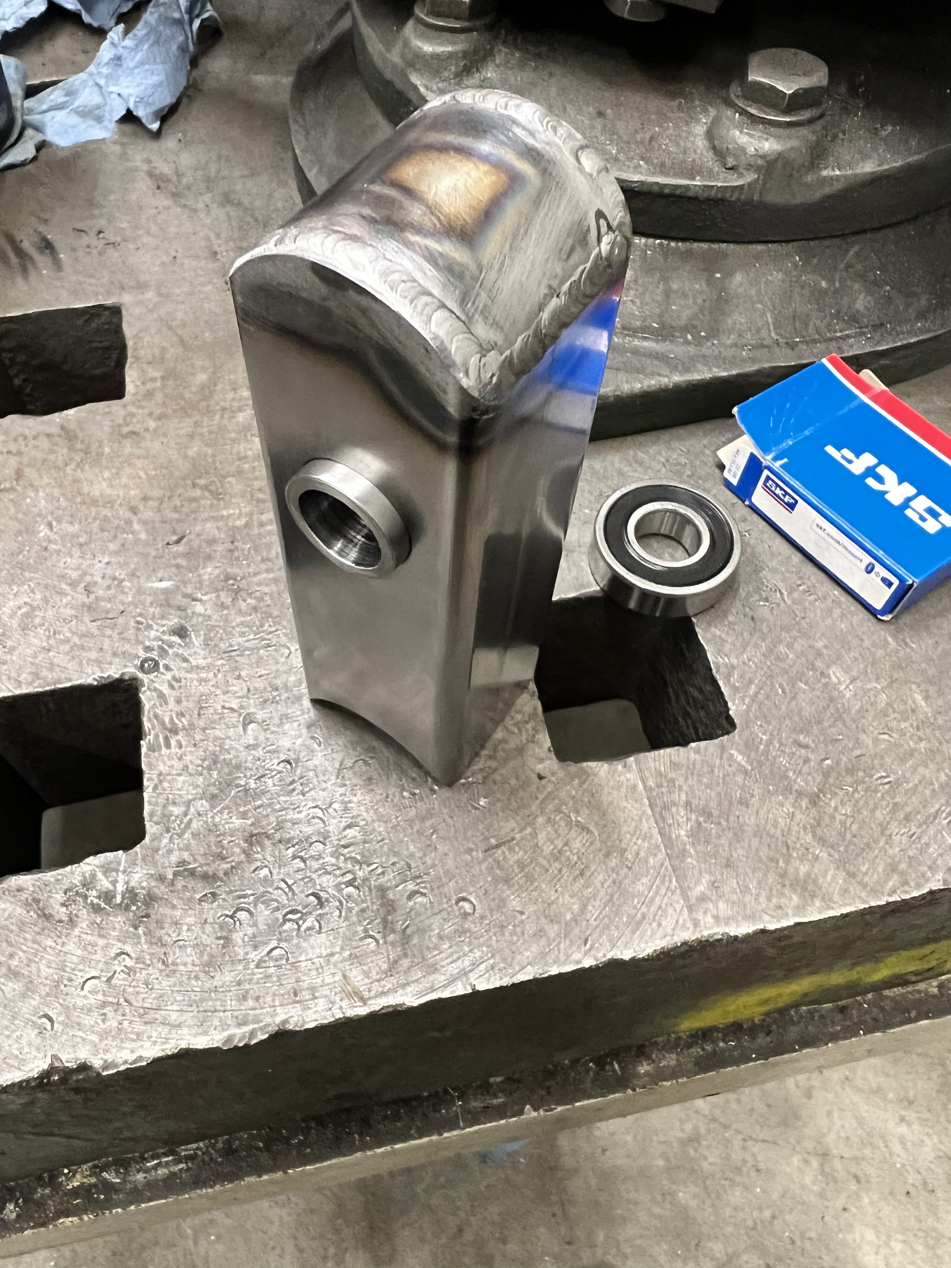

Not much progress, spent 6 hours. Main pivot tube was a pain to weld with no pedal or button I reamed it before and after welding, was perfect before welding, but ended up 15.1 mm after weld reaming, bearing is 15.01. Axle now has to have caps on both sides.

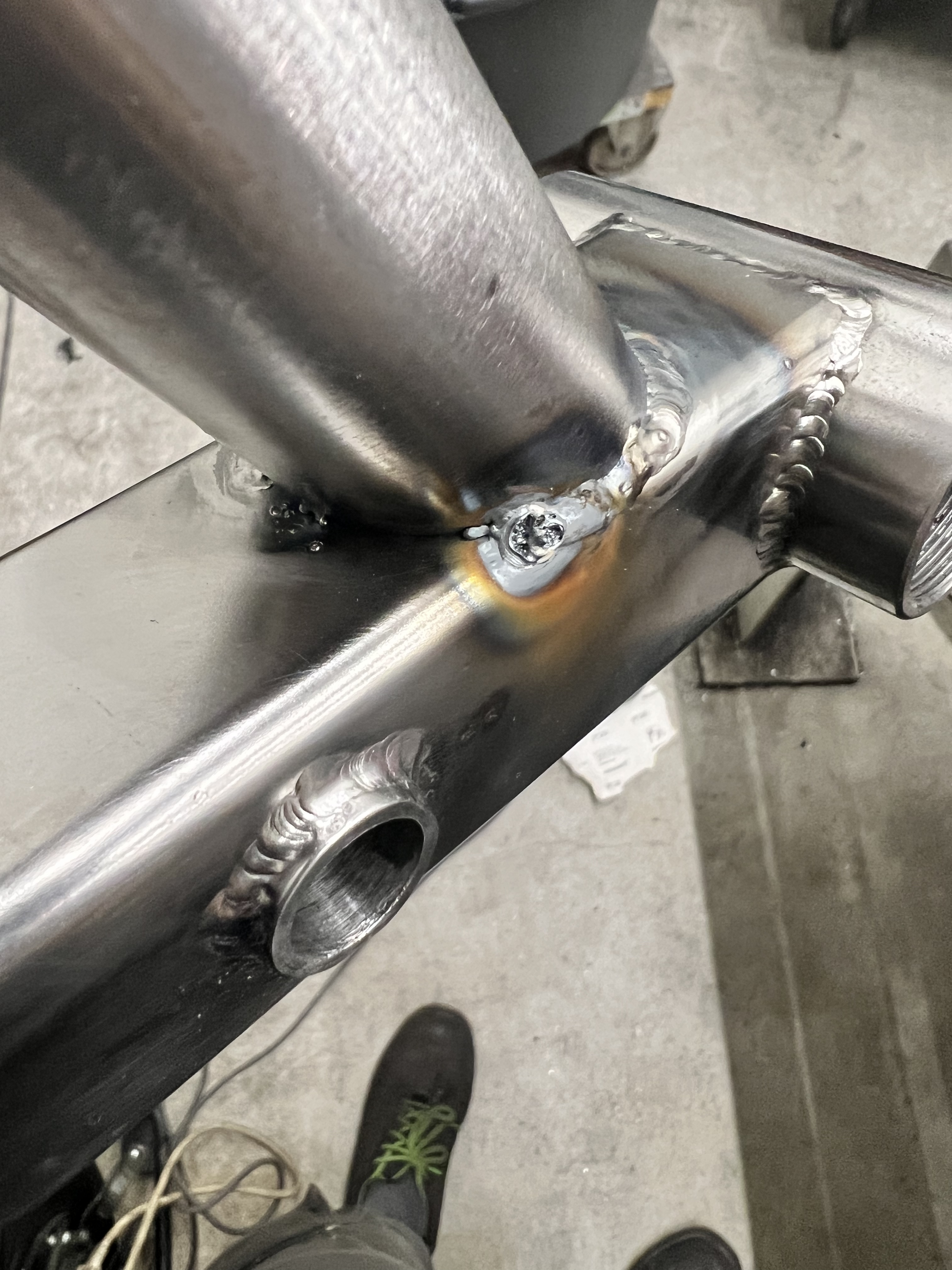

HELP! So guys I’m welding my seat tube and I have a problem. Sparks are flying and oxidizing only in one spot. When I try to weld on practice piece I have no problems. I have tried to clean and cut weld off to re weld it but every time sparks start to fly at the same spot. What could be the problem?
I started my welding from there and I had no problem. I did start with way too low amps and had no idea how to weld it so at the front we can see a failed tacking attempt and my first side weld (where I’m having problems) was also too cold. But I have never had problem over welding anything. Is it pushing air out from the inside? I did not make a breathing hole (forgot), but it should not be a problem because ST is open at the top. Basically I have no idea what is going on.
