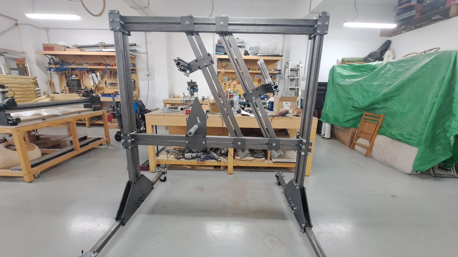

Hi! new builder here from Barcelona!
Slowly making my first frame, plus the tooling :joy:
This is the frame Jig i designed and made, did millions of iterations until i came to this which is pretty simple imo and happy with the result, i checked everything and it’s right on! Plus it’s on wheels!

I hope you have a really long T square, i’m imagining a really beautiful vintage wooden one, maybe with a few scorch marks…
nice work on the jig, looks sturdy. I know at least one other beginning Framebuilder in barća (barna?) who’s also working their way through the tooling problem, if you want someone local to bounce ideas off, and borrow brazing rod from when you run out, I can pass on a contact; dm me.
Cheers man,
It’s still a working progress but came out pretty straight being mild steel tubing plus the Laser cut without machining.
Are you talking about Jordi? or Cristian?
neither, so it sounds like you need to start a workshop night!
You will have some alignment issues, your design looks great but the steel square tubing is never straight. I use 2x5 and 2x2 square tubing on my jig as well and even on short length like 1m I have several millimeters of misalignment.
My jig was designed in a way so I can use a laser adapter on the BB to align every part of it, it’s a pain to do it but it’s a way to have it actually be straight.
I would consider a similar solution to align it as well if you don’t have it already.
Square tubing varies in quality. If you get the stuff called “bright mild” (in UK) it’s usually straighter. It’s very good from my local supplier. But I still made my jig adjustable in all the key dimensions so I can check it with a laser (or just by eye which I actually think is more accurate). Also because I made it all with hand-tools.
Hi Matt,
I checked with the laser alignment and everything came out dead straight!

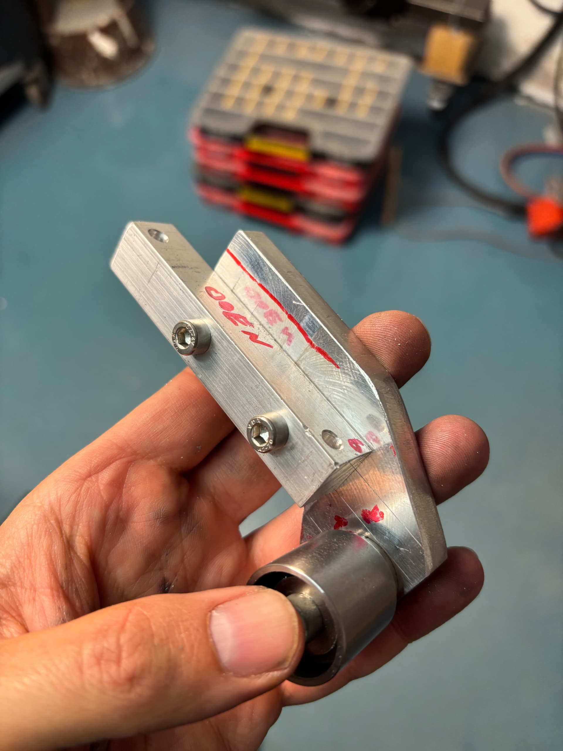

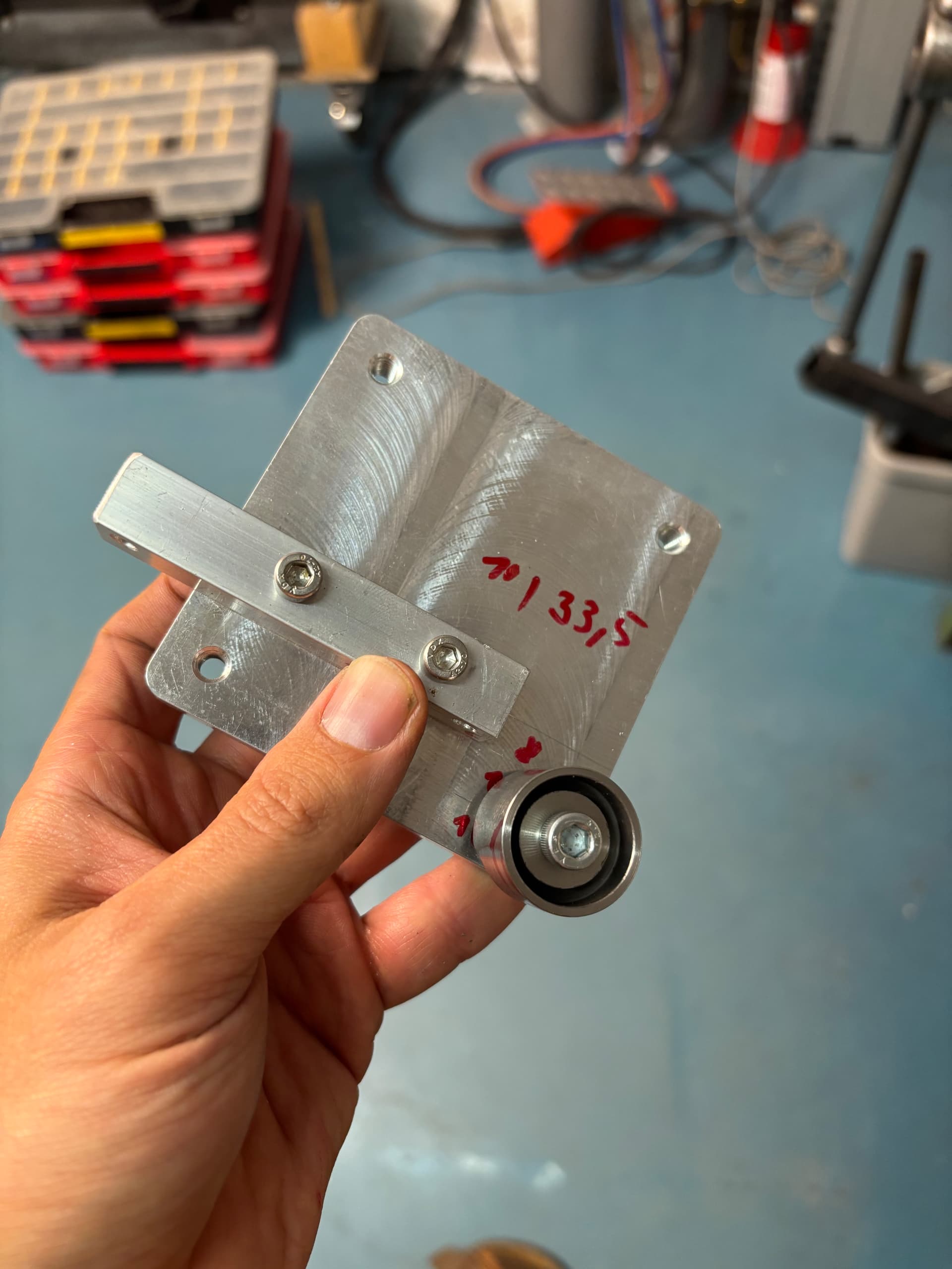

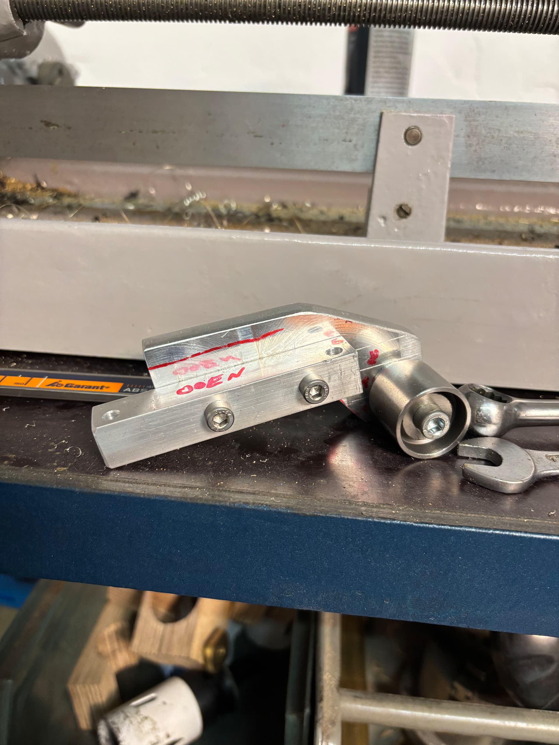

Made a Flatmount jig to position the bosses on the chainstay. Some alu scrap, a drill press and a lathe and an evening of time…
^ I endorse this whole heartedly.

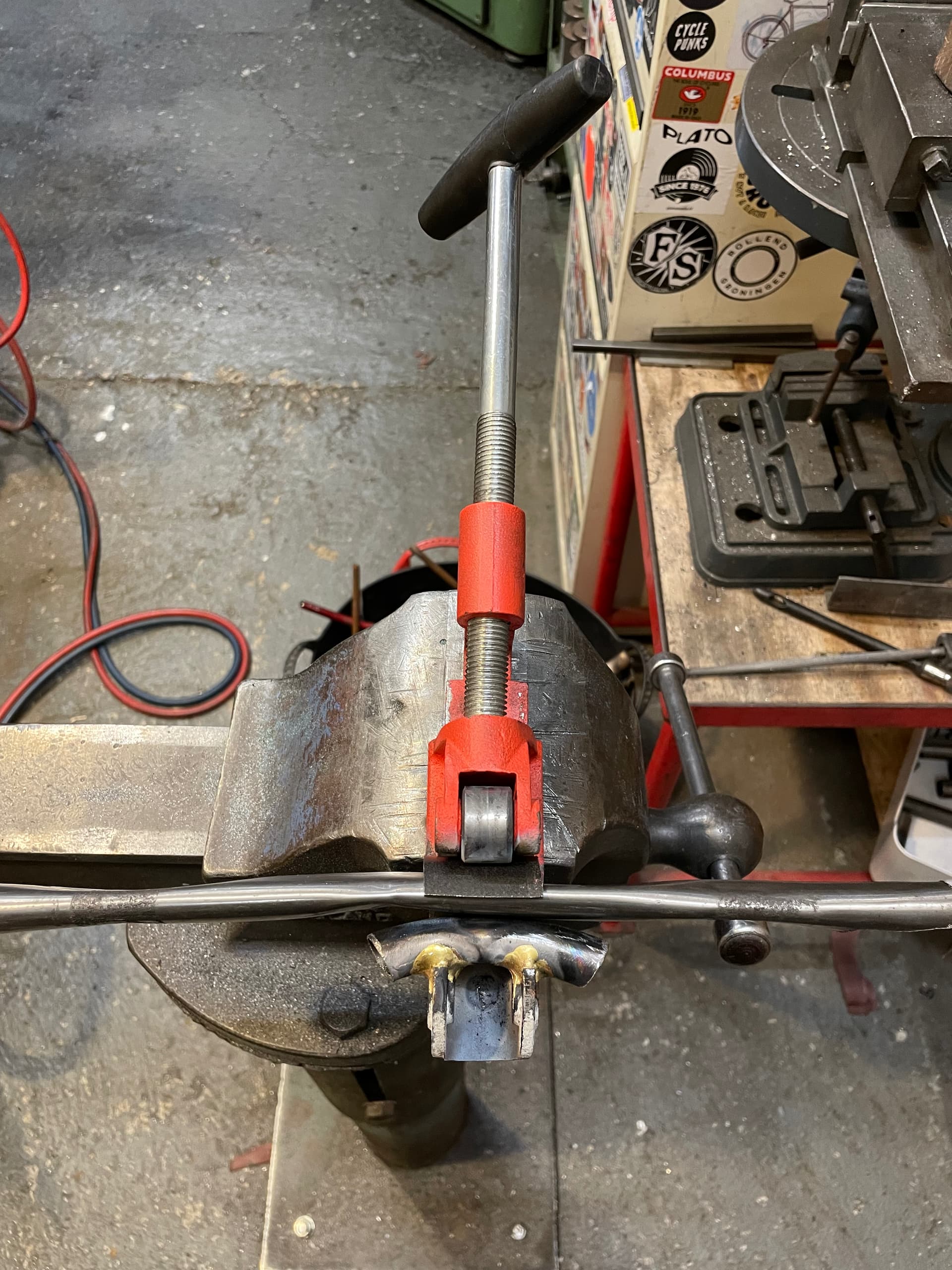

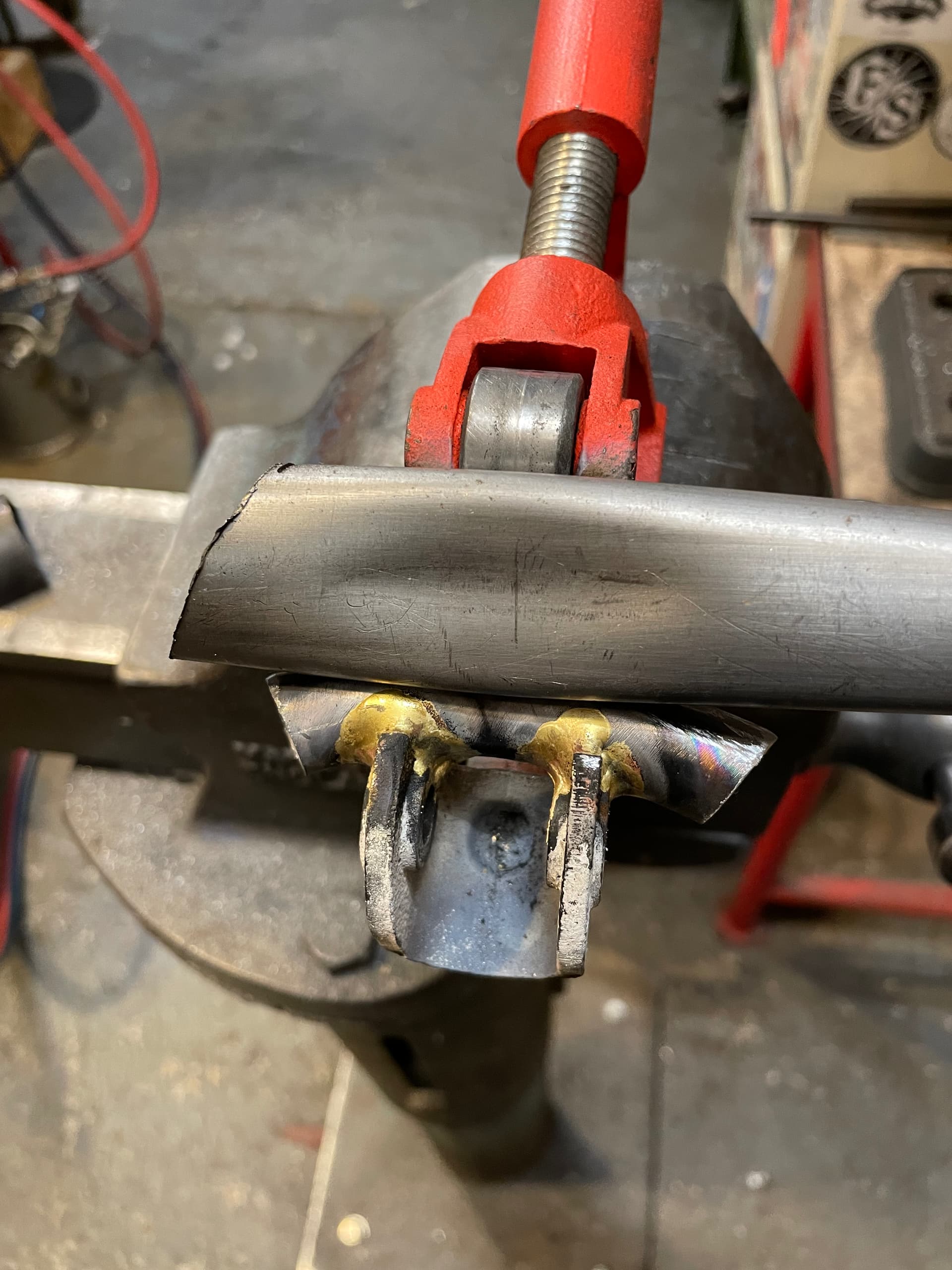

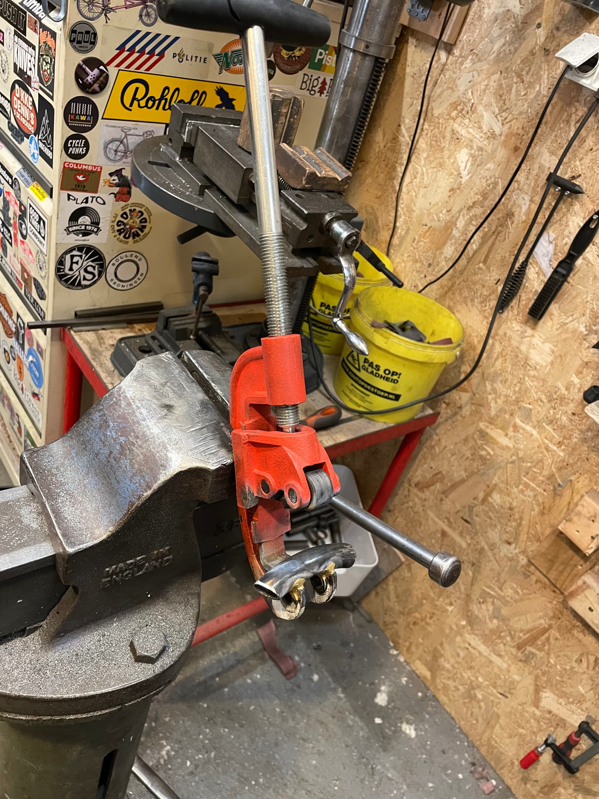

Dimpler from a a tube cutter
I think we all need some more photos of the dimpler.
This the only other picture I took.
Removed the cutting wheel, and brazed a piece of 20mm curved tubing there.
